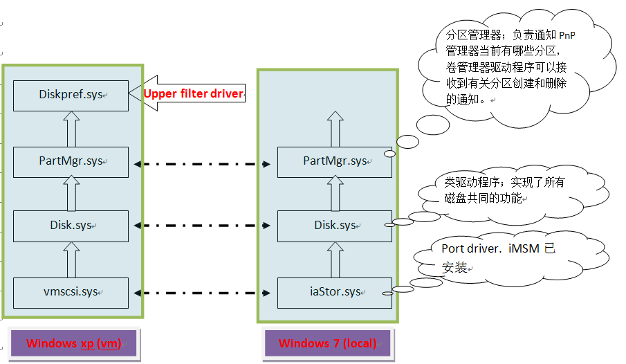

<<分析diskpref.sys的设备栈信息>>
kd> !drvobj diskperf
Driver object (8213c2c0) is for:
\Driver\diskperf
Driver Extension List: (id , addr)
Device Object list:
81ded020
kd> !devobj 81ded020
Device object (81ded020) is for:
  \Driver\diskperf DriverObject 8213c2c0
Current Irp 00000000 RefCount 0 Type 00000007 Flags 00000010
Vpb 81ccc1d8 DevExt 81ded0d8 DevObjExt 81ded1d8 Dope 8219e950
ExtensionFlags (0000000000)
AttachedTo (Lower) 8219e020 \Driver\PartMgr
Device queue is not busy.
kd> !devobj 8219e020
Device object (8219e020) is for:
  \Driver\PartMgr DriverObject 82053cb0
Vpb 821deb98 DevExt 8219e0d8 DevObjExt 8219e1e8 Dope 8213cc08
AttachedDevice (Upper) 81ded020 \Driver\diskperf
AttachedTo (Lower) 82051030 \Driver\Disk
kd> !devobj 82051030
Device object (82051030) is for:
DR0 \Driver\Disk DriverObject 82053300
Current Irp 00000000 RefCount 0 Type 00000007 Flags 00000050
Vpb 821a50b0 Dacl e132122c DevExt 820510e8 DevObjExt 82051548 Dope 81ccd418
AttachedDevice (Upper) 8219e020 \Driver\PartMgr
AttachedTo (Lower) 82052a38 \Driver\vmscsi
kd> !devobj 82052a38
Device object (82052a38) is for:
vmscsi1Port1Path0Target0Lun0 \Driver\vmscsi DriverObject 8205e8b0
Current Irp 00000000 RefCount 0 Type 00000007 Flags 00001050
Dacl e132122c DevExt 82052af0 DevObjExt 82052fd0 Dope 82189178 DevNode 81ccb8e8
AttachedDevice (Upper) 82051030 \Driver\Disk
Scsiport.sys:针对SCSI总线上的磁盘的端口驱动程序
Atapi.sys:针对IDE系统的端口驱动程序
这2个驱动都实现了磁盘调度算法:C-LOOK

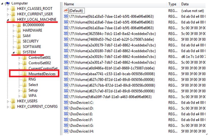

MountMgr.sys:挂载管理器设备驱动程序(一个功能驱动),其为以下设备分配驱动器字母:
在windows安装以后创建的动态磁盘卷和基本磁盘卷、CD-ROM、软盘驱动器和可移动设备。
其将字母分配信息存储在HKLM\SYSTEM\MountedDevices中。
