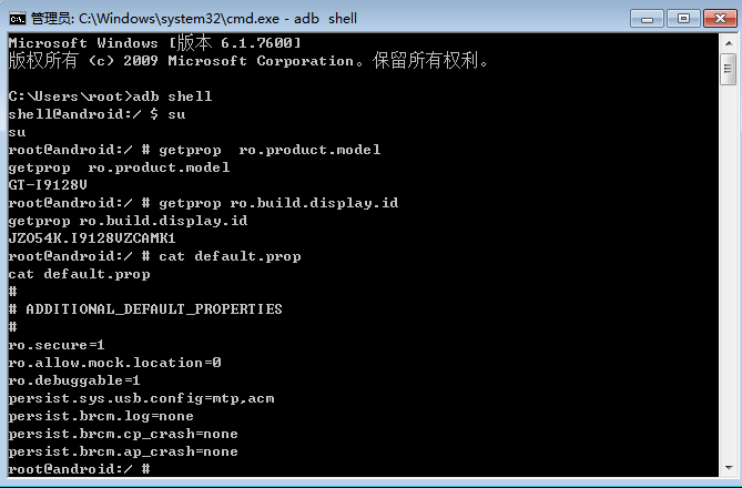

   第三步就是root,尝试各种姿势,总得来说数字的最挫,下来是完美,最后还是root大师搞定的。这时候用adb shell可以连上去,命令如下:
C:\Users\root>adb shell
* daemon not running. starting it now on port 5037 *
* daemon started successfully *
shell@android:/ $ su
su
root@android:/ # id
id
uid=0(root) gid=0(root)
root@android:/ # pwd
pwd
root@android:/ # cat default.prop
cat default.prop
# ADDITIONAL_DEFAULT_PROPERTIES
ro.secure=1
ro.allow.mock.location=0
ro.debuggable=1
persist.sys.usb.config=mtp,acm
persist.brcm.log=none
persist.brcm.cp_crash=none
persist.brcm.ap_crash=none
root@android:/ #
