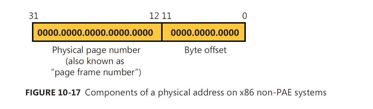

The job of virtual address translation is to convert these virtual addresses into physical addresses—
that is, addresses of locations in RAM. The format of a physical address on an x86 non-PAE system is
shown in Figure 10-17.
虚拟地址翻译,这项工作就是把虚拟地址转换成物理地址——亦即,RAM(随机访问存储器)中位置的地址。在非 PAE 的 x86 系统上,物理地址的格式如图 10-17 所示。
As you can see, the format is very similar to that of a virtual address. Furthermore, the byte offset
value from a virtual address will be the same in the resulting physical address. We can say, then, that
address translation involves converting virtual page numbers to physical page numbers (also referred
to as page frame numbers, or PFNs). The byte offset does not participate in, and does not change as a
result of, address translation. It is simply copied from the virtual address to the physical address,
如你所见,它的格式与虚拟地址非常相似。此外,转换产生的物理地址中的“字节偏移”值,将与原虚拟地址中的相同。
如此一来,我们可以说,地址翻译涉及把虚拟页号转换成物理页号(亦称为“页框号”,或 PFN)。事实上,“字节偏移”并不参与转换过程,也不因地址转换的结果而改变——只是简单地把它从虚拟地址复制到物理地址中。

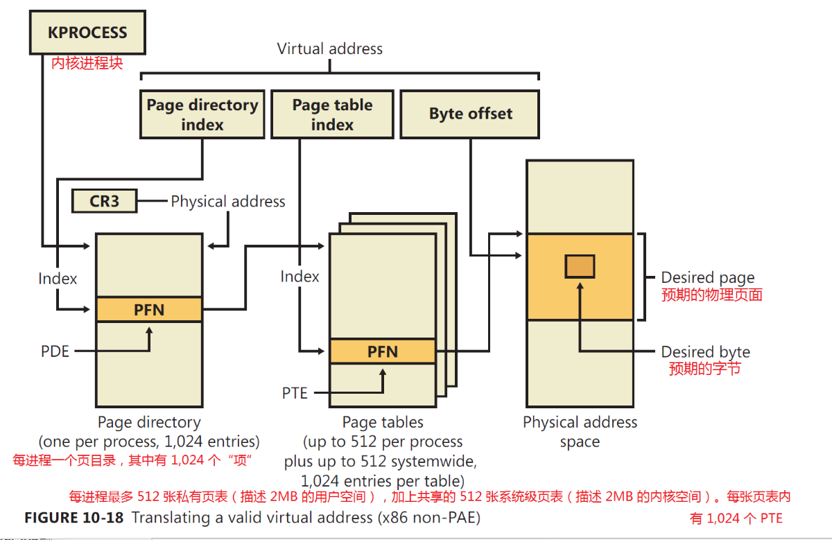

Figure 10-18 shows the relationship of these three values and how they are used to perform address
translation.
图 10-18 描绘了这三个值(字段)之间的关系,以及它们如何被用来执行地址翻译。
The following basic steps are involved in translating a virtual address:
1. The memory management unit (MMU) uses a privileged CPU register, CR3, to obtain the
physical address of the page directory.
2. The page directory index portion of the virtual address is used as an index into the page
directory.
This locates the page directory entry (PDE) that contains the location of the page table needed to map the virtual
address.
The PDE in turn contains the physical page number, also called the page frame number, or PFN, of the desired page table,
provided the page table is resident—page tables can be paged out or not yet created, and in those cases, the page
table is first made resident before proceeding.
If a flag in the PDE indicates that it describes a large page, then it simply contains the PFN of the target large page,
and the rest of the virtual address is treated as the byte offset within the large page.
3. The page table index is used as an index into the page table to locate the PTE that describes
the virtual page in question.
4. If the PTE’s valid bit is clear, this triggers a page fault (memory management fault). The operating
system’s memory management fault handler (pager) locates the page and tries to make
it valid; after doing so, this sequence continues at step 5. (See the section “Page Fault Handling.”)
If the page cannot or should not be made valid (for example, because of a protection
fault), the fault handler generates an access violation or a bug check.
5. When the PTE describes a valid page (whether immediately or after page fault resolution), the
desired physical address is constructed from the PFN field of the PTE, followed by the byte
offset field from the original virtual address.
Now that you have the overall picture, let’s look at the detailed structure of page directories, page
tables, and PTEs.
翻译一个虚拟地址涉及到以下基本步骤:
1。内存管理单元使用一个叫做 CR3 的特权 CPU 寄存器,来获取页目录的物理地址。
2。虚拟地址中的“页目录索引”部分被用于索引页目录中的“项”(PDE)。这就能够找到特定的 PDE ,它含有映射虚拟地址必需
   的页表位置。换言之,PDE 中包含:所期望页表的物理页号,或称页框号,或 PFN——在该页表驻留物理内存的条件下——
   页表可以被换出物理内存,或根本尚未创建,在后两种情况中,首先要让该页表驻留在物理内存中,才能进行后续处理。
   如果 PDE 中的一个标志指出它描述的是一个大页,那它就包含目标大页的 PFN,而虚拟地址的其余部分被视为该大页内的字节偏移。
3。“页表索引”被用于在页表中,找出负责描述相关虚拟页的 PTE。(译注:如图所示,PTE 包含所期望“页面”的 PFN)
4。 如果该 PTE 的有效位被清除,这将触发一次页错误(内存管理故障)。操作系统的内存管理故障处理程序(换页器)会找到
    该页面,并试图让它有效(请参考“页错误处理”一节);在此之后,继续步骤 5 中的操作。
    如果无法或者不应该将此页面设置为有效(比如,由于页保护导致的错误),错误处理程序生成一个非法访问异常,或者 bug check
    蓝屏。(译注:即,崩溃在内核模式下)
5。当该 PTE 能够描述一个有效的页面时(无论在当下,还是在分页异常得到解决后),就从该 PTE 的 PFN 字段构建出期望的物理地址,
   后面紧跟着原始虚拟地址中的“字节偏移”字段。
现在你已经掌握了地址翻译的大局,让我们再来研究页目录,页表,以及页表项的细部结构。

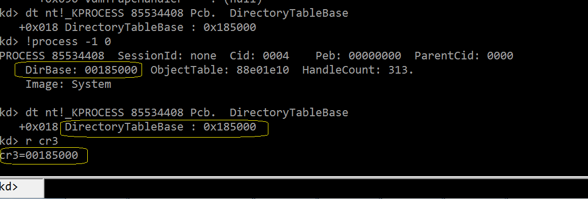

(译注:我又来罗嗦几句了——既然原书作者喜欢卖关子,那我就要把前面讲过的一些知识点联系在一起,并且通过实战来总结,如下图所示
,调试机上运行 Windbg.exe ,通过命名管道模拟连接至被调试虚拟机上的 COM 口,后者以调试模式启动,整个命令带上参数可以是这样:
Windbg.exe -n -v -logo d:\kernel_realtime_debugging.txt -k com:pipe,port=\\.\pipe\com_1,baud=115200,reconnect
其中,“-logo”选项后接用来记录调试日志的文件路径。
下图显示出,被调试机上当前运行着 System 进程,它的页目录物理基地址是 0x00185000,这与 CR3 的当前值一致;
System 进程的“执行体进程块”——EPROCESS 结构——的虚拟地址为 0x85534408 ;由于 EPROCESS 结构中的第一个字段“Pcb”就是
一个内嵌的 KPROCESS 结构,因此它的地址就是内核进程块的地址,这就是为啥用 dt 命令转储内核进程块的 DirectoryTableBase 字段值时,
可以接上 EPROCESS 结构起始虚拟地址的原因。这个字段也指向 0x00185000,上下文切换就涉及把目标进程的 DirectoryTableBase 值
装载到 CR3 中)

Each page directory entry points to a page table. A page table is a simple array of PTEs. The virtual
address’s page table index field (as shown in Figure 10-18) indicates which PTE within the page table
corresponds to and describes the data page in question.
The page table index is 10 bits wide,  allowing you to reference up to 1,024 4-byte PTEs.
Of course, because x86 provides a 4-GB virtual address
space, more than one page table is needed to map the entire address space.
To calculate the number of page tables required to map the entire 4-GB virtual address space, divide 4 GB by the
virtual memory mapped by a single page table.
Recall that each page table on an x86 system maps 4 MB of
data pages. Thus, 1,024 page tables (4 GB / 4 MB) are required to map the full 4-GB address space.
This corresponds with the 1,024 entries in the page directory.
页表与页表项
每个页目录项都指向一张页表。页表就是一个由 PTE 构成的数组。虚拟地址中的“页表索引”字段(请回顾图 10-18)指出它对应于
页表内的哪一个 PTE,而后者描述了与其相关的数据页。“页表索引”的宽度是 10 位,让它最多能够引用 1,024 个四字节长度的 PTE。
当然,由于 x86 提供了一个 4GB 的虚拟地址空间,这就需要不止一张页表,才能够映射完整个地址空间。
为了计算映射整个 4GB 虚拟地址空间所需的页表数量,可以把 4GB 除以由单张页表映射的虚拟内存范围。
回想一下:x86 系统上的每张页表映射 4 MB 范围的数据页。因此,需要 1,024 张页表(4 GB / 4 MB)来映射整个 4GB 地址空间。
这就对应了页目录中的 1,024 个“项”(即 PDE)。

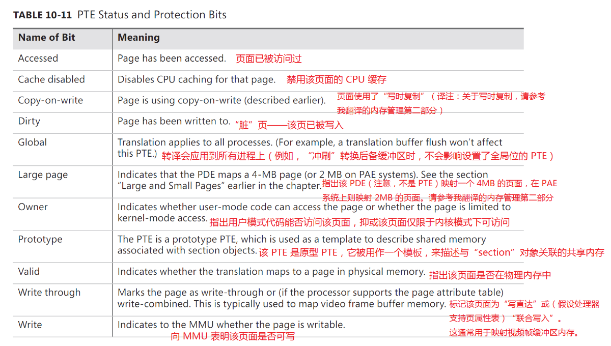

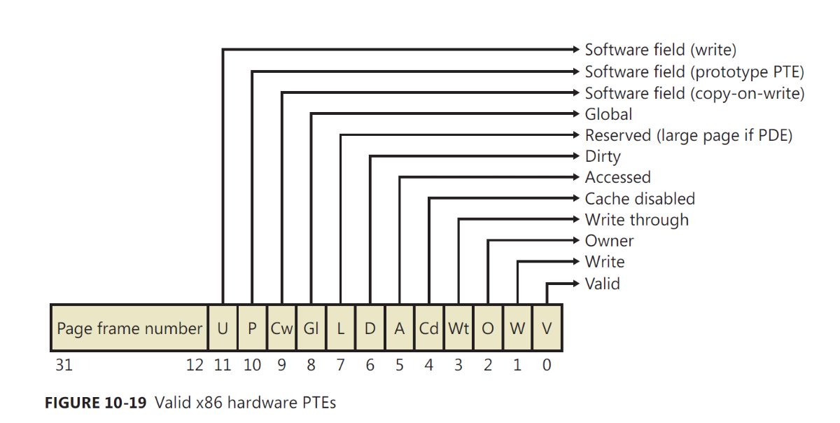

You can use the !pte command in the kernel debugger to examine PTEs. (See the experiment
“Translating Addresses.”) We’ll discuss valid PTEs here and invalid PTEs in a later section. Valid PTEs
have two main fields: the page frame number (PFN) of the physical page containing the data or of the
physical address of a page in memory, and some flags that describe the state and protection of the
page, as shown in Figure 10-19.
你可以使用内核调试器的“!pte”命令查看 PTE。(参考实验:“地址翻译”)
此处我们将讨论有效的 PTE,在后续部分讨论无效的 PTE。有效 PTE 的两个主要字段,即物理页(包含数据)的页框号(PFN),
或 RAM 中页面物理地址的页框号,另一个字段则是描述该页面状态和保护信息的一些标志位,如图 10-19 所示。
As you’ll see later, the bits labeled “Software field” and “Reserved” in Figure 10-19 are ignored by
the MMU, whether or not the PTE is valid. These bits are stored and interpreted by the memory manager.
Table 10-11 briefly describes the hardware-defined bits in a valid PTE.
正如您稍候将要看到的,CPU 的内存管理单元(MMU)会忽略掉图 10-19 中,被标记为“Software field”和 “Reserved”的位,
无论这个 PTE 是否有效。图 10-19 中的这些位由内存管理器存储并解释。表 10-11 将一个有效 PTE 中,那些硬件定义的位作了简短
介绍。
On x86 systems, a hardware PTE contains two bits that can be changed by the MMU, the Dirty bit
and the Accessed bit. The MMU sets the Accessed bit whenever the page is read or written (provided
it is not already set).
The MMU sets the Dirty bit whenever a write operation occurs to the page.
The
operating system is responsible for clearing these bits at the appropriate times; they are never cleared
by the MMU.
在 x86 系统上,硬件 PTE 包含两个可由 MMU 更改的比特位,即“脏位”和“访问位”。每当该页面被读取或写入时,MMU 就会设置
访问位(只要它未被设置)。
每当该页面发生一次写操作时,MMU 就会设置脏位。操作系统负责在适当的时间清除这些位;MMU 从不清除它们。
The x86 MMU uses a Write bit to provide page protection. When this bit is clear, the page is readonly;
when it is set, the page is read/write.
If a thread attempts to write to a page with the Write bit
clear, a memory management exception occurs, and the memory manager’s access fault handler (described
later in the chapter) must determine whether the thread can be allowed to write to the page
(for example, if the page was really marked copy-on-write) or whether an access violation should be
generated.
 x86 MMU 借助“Write bit”来提供页面保护机制。当此位清 0 时,对应的页面是只读的;当此位置 1 时,对应的页面可读写。
 如果一个线程试图向“Write bit”清 0 的页面写入,就会引发一次内存管理异常,而内存管理器的“访问错误处理程序”(
 本章稍后会讲到)必须确定:该线程是否被允许写入这个页面(比如,目标页面确实标记了“写时复制”),或者是否应该产生
 一个“非法访问”异常。

Byte Within Page
Once the memory manager has determined the physical page number, it must locate the requested
data within that page. This is the purpose of the byte offset field. The byte offset from the original
virtual address is simply copied to the corresponding field in the physical address. On x86 systems,
the byte offset is 12 bits wide, allowing you to reference up to 4,096 bytes of data (the size of a page).
Another way to interpret this is that the byte offset from the virtual address is concatenated to the
physical page number retrieved from the PTE. This completes the translation of a virtual address to a
physical address.
页内字节
一旦内存管理器确定出物理页号,它必须在该页内找到所请求的数据。这就是“字节偏移”域的作用。
就是简单地把原始虚拟地址中的“字节偏移”复制到物理地址中的对应字段。
在 x86 系统上,“字节偏移”为 12 位宽,这允许你引用最多 4,096 字节的数据(即一张页的大小)
另一种解释为:从该 PTE 中检索出物理页号,接着把虚拟地址中的“字节偏移”字段串联其后。
这就完成了从虚拟地址到物理地址的转换。

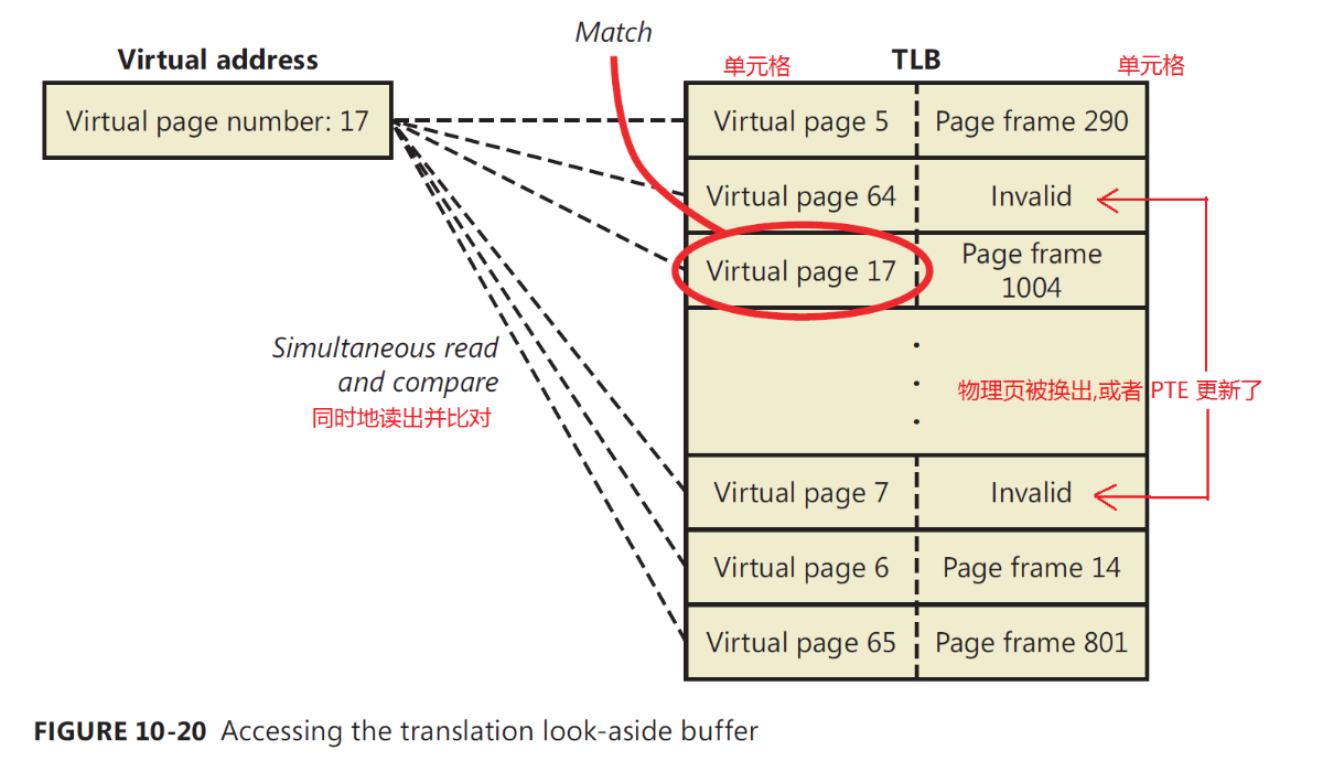

Translation Look-Aside Buffer
As you’ve learned so far, each hardware address translation requires two lookups: one to find the right
entry in the page directory (which provides the location of the page table) and one to find the right
entry in the page table.
Because doing two additional memory lookups for every reference to a virtual
address would triple the required bandwidth to memory, resulting in poor performance, all CPUs
cache address translations so that repeated accesses to the same addresses don’t have to be repeatedly
translated.
This cache is an array of associative memory called the translation look-aside buffer, or
TLB. Associative memory is a vector whose cells can be read simultaneously and compared to a target
value.
In the case of the TLB, the vector contains the virtual-to-physical page mappings of the most
recently used pages, as shown in Figure 10-20, and the type of page protection, size, attributes, and
so on applied to each page.
Each entry in the TLB is like a cache entry whose tag holds portions of the
virtual address and whose data portion holds a physical page number, protection field, valid bit, and
usually a dirty bit indicating the condition of the page to which the cached PTE corresponds.
If a PTE’s global bit is set (as is done by Windows for system space pages that are visible to all processes), the
TLB entry isn’t invalidated on process context switches.
转换后援缓冲区
正如你迄今所了解的,每个硬件地址翻译要求两次查询:第一次在页目录中找出正确的项(它给出页表的位置),第二次在页表
中找到正确的项。
由于为每个虚拟地址的引用执行两次额外的内存查找,将需要原本三倍到存储器的带宽,导致性能恶劣,所有 CPU 都会缓存地址翻译
的结果,使得重复访问相同地址无需屡次转换。
这个缓存是由“相联存储器”构成的数组,它叫做“转换后援缓冲区”,或简称 TLB。相联存储器是一个“向量”,它内部的单元可被
同时地读取,并与目标值进行比较。(译注:硬件 TLB 通常集成在 CPU 的一级高速缓存内部,因此不要把作者提到的相联“存储器” 与主存储器/内存
混淆,它们有着本质上的区别。)
就 TLB 而言,该向量包含最近使用过页面的虚拟-物理页映射,页保护的类型,大小,属性,诸如此类应用至每个页面的信息。。。。
如图 10-20 所示。
(译注:我说一些废话:既然有区分指令 L1 cache 与数据 L1 cache,它们各自就集成了指令 TLB 与数据 TLB,分别用来缓存
某指令所在的虚拟-物理页映射,以及某数据所在的虚拟-物理页映射,从而加速 CPU 取出指令与数据——以 Intel 的“Core”核心架构为例)
TLB 中的每一项类似于一个缓存条目,其“标签”部分持有虚拟地址,其“数据”部分持有物理页号,保护字段,有效位,通常
还有“脏位”,指出与缓存的 PTE 对应的页面处于何种状况。
假设一个 PTE 中的“全局”位被设置了(就像 Windows 为所有进程可见/共享的系统空间页面所设定的那样),相应的 TLB 条目
就不会在进程上下文切换期间(译注:根据前文,还有“冲刷”TLB 时)失效。
Virtual addresses that are used frequently are likely to have entries in the TLB, which provides
extremely fast virtual-to-physical address translation and, therefore, fast memory access.
If a virtual address isn’t in the TLB, it might still be in memory, but multiple memory accesses are needed to find
it, which makes the access time slightly slower.
If a virtual page has been paged out of memory or if
the memory manager changes the PTE, the memory manager is required to explicitly invalidate the
TLB entry.
If a process accesses it again, a page fault occurs, and the memory manager brings the
page back into memory (if needed) and re-creates its PTE entry (which then results in an entry for it
in the TLB).
频繁用到的虚拟地址很可能在 TLB 中有对应的条目,这就提供了极快的虚拟-物理地址转换过程,故而快速的内存访问(译注:只需
一次物理内存访问即可取出指令或代码,这就是为啥无论在所需时间和带宽上,都只有“循规蹈矩”地址翻译的三分之一。)
如果某个虚拟地址在 TLB 中没有对应的项,就可能仍在内存中,而需要多次主存储器访问才能找到,使得访问时间稍慢一些(与
页面被换出内存相比)。
如果虚拟页已经被换出主存储器,或者内存管理器变更了 PTE,它就需要显式地让相应的 TLB 条目失效。(译注:这很好理解:
PTE 描述的物理页变了,原 TLB 中记录的当然是错误的转换结果)
当一个进程再次访问已经被换出的虚拟页时,就会发生一次页错误,然后内存管理器把该页面换回内存(如有必要),并重建它的
PTE 项(而后导致在 TLB 中缓存相应的条目)。

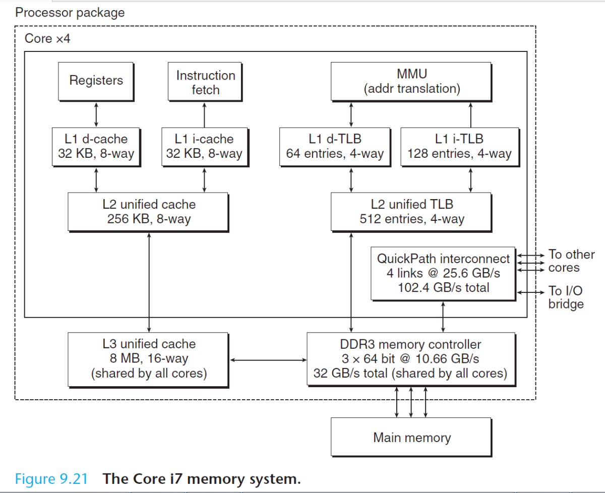

来看看真实世界中的 TLB 在 CPU 封装内是如何布局的,以 Intel Core I7 处理器为例子,如下图所示,可以看到, TLB 也按照指令和数据来划分,而且与硬件高速缓存一样,具有层次结构。注意,L1~L2 TLB 是虚拟寻址;而
L1~L3 Cache 则是物理寻址。CPU 翻译一个虚拟地址涉及发送虚拟页号(VPN)到 MMU,以及发送虚拟页字节偏移(VPO)到 L1 Cache,这两个发送是“并行”开展的,同时查找缓存在 TLB 中的物理页号(PPN)和 L1 Cache 中的物理页字节偏移(PPO)。PPN + PPO 就得出物理地址。视具体情况而定,也有可能像前面译文讲的那样,先从虚拟地址中复制字节偏移到物理地址中相应的字段,再用得出的物理地址到 L1 Cache 中查询有无相应条目缓存。但这个“顺序”查找就比“同时”查找慢了“一些”时钟周期。假设级联式的 TLB 都未命中,或者 Cache 都未命中,就需要到内存中查找,这就会慢“很多”时钟周期。

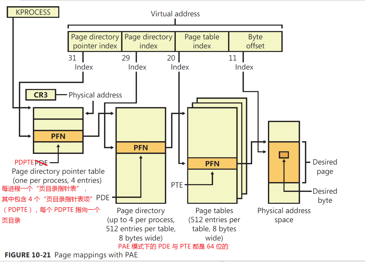

Physical Address Extension (PAE)
The Intel x86 Pentium Pro processor introduced a memory-mapping mode called Physical Address
Extension (PAE). With the proper chipset, the PAE mode allows 32-bit operating systems access to up
to 64 GB of physical memory on current Intel x86 processors (up from 4 GB without PAE) and up to
1,024 GB of physical memory when running on x64 processors in legacy mode (although Windows
currently limits this to 64 GB due to the size of the PFN database required to describe so much
memory). When the processor is running in PAE mode, the memory management unit (MMU) divides
virtual addresses mapped by normal pages into four fields, as shown in Figure 10-21. The MMU still
implements page directories and page tables, but under PAE a third level, the page directory pointer
table, exists above them.
物理地址扩展(PAE)
从 Intel x86 Pentium Pro 处理器开始,引入了一种叫做“物理地址扩展”(PAE)的内存映射模式。
搭配适当的芯片组,PAE 模式允许 32 位操作系统在当前的 Intel x86 处理器上,访问多达 64 GB 的物理内存(没有启用 PAE 则是 4GB);

当处理器运行在 PAE 模式,它的内存管理单元(MMU)把映射正常页面的虚拟地址划分为四个字段,如图 10-21 所示。
MMU 仍旧实现了页目录与页表,但在 PAE 模式下,这是一个三级的数据结构,“页目录指针表”(PDPT)位于最上层。

This then leaves the two high-order bits of the virtual address unaccounted for. So PAE expands
the number of page directories from one to four and adds a third-level address translation table,
called the page directory pointer table, or PDPT. This table contains only four entries, 8 bytes each,
which provide the PFNs of the four page directories. The two high-order bits of the virtual address are
used to index into the PDPT and are called the page directory pointer index.
我们剩下虚拟地址中最高的 2 位还没解释。
因此,PAE 把页目录的数量从一个扩展到了四个,并且增加了一个第三级的地址转换表,叫做页目录指针表,或简称 PDPT。
它只包含四个条目,每个大小 8 字节,它们用来提供四个页目录的 PFN。
现在你就能够推测到,虚拟地址中的两个最高位,用于索引 PDPT 内的条目,叫做页目录指针索引。
As before, CR3 provides the location of the top-level table, but that is now the PDPT rather than
the page directory. The PDPT must be aligned on a 32-byte boundary and must furthermore reside in
the first 4 GB of RAM (because CR3 on x86 is only a 32-bit register, even with PAE enabled).
Note that PAE mode can address more memory than the standard translation mode not directly
because of the extra level of translation, but because the physical address format has been expanded.
The extra level of translation is required to allow processing of all 32 bits of a virtual address.
CR3 依旧给出了顶级“表格”的位置,该“表格”现在是 PDPT,而非页目录。
PDPT 必须在 32 字节的边界上对齐,此外还需要驻留在首个 4 GB 的物理内存中。
(这是由于,x86 的 CR3 寄存器只有 32 位,和 PAE 启用与否无关)
请注意,PAE 模式能够寻址比标准翻译模式更多的内存,其直接原因并非是追加了额外翻译层的关系,而是由于物理地址的格式被扩展了。
因此,需要额外的翻译层,才能够处理一个虚拟地址中的全部 32 位。

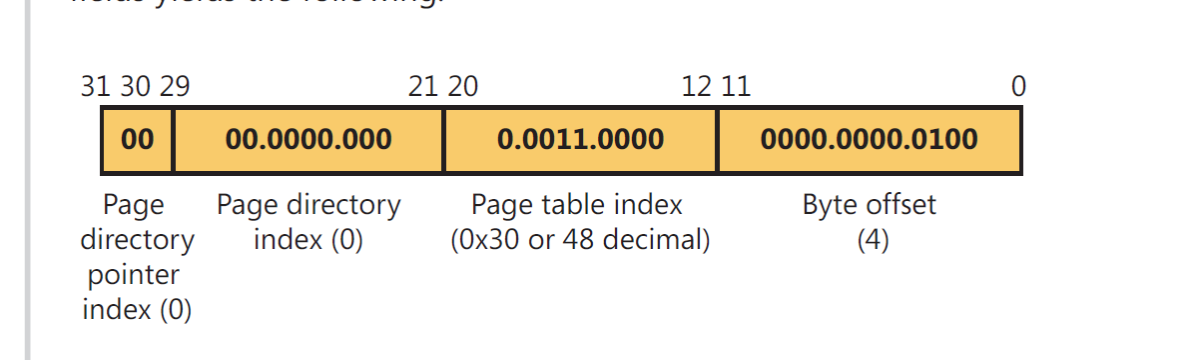

First let’s convert 0x30004 to binary and break it into the three fields that are used to translate
an address. In binary, 0x30004 is 11.0000.0000.0000.0100. Breaking it into the component
fields yields the following:
实验:地址转译
本实验会演示在一个 x86 PAE 系统上转译虚拟地址的真实案例,以便把地址转译的原理说清楚讲明白,使用内核调试器中可用的工具(命令),来审查 PDPT,页目录,页表,以及页表项。
(如前所述——作者比我还罗嗦——在当今启用了 PAE 模式的 x86 处理器上运行 Windows 是很常见的,甚至少于 4 GB 物理内存的系统也运行在 PAE 模式下,因为需要 PAE 模式才能够启用不可执行内存的访问保护。)
在这个例子中,我们将要剖析的进程虚拟地址为 0x30004,当前被映射到一个有效的物理地址。而在稍后的例子中,你将看到如何通过内核调试器来为无效地址跟踪它的转换过程。
1。首先,我们把 0x30004 转换为二进制表示,再将其分解成用于翻译地址的三个字段。0x30004 的二进制表示为“11.0000.0000.0000.0100”。分解后的组成字段如下图所示:
To start the translation process, the CPU needs the physical address of the process’s page
directory pointer table, found in the CR3 register while a thread in that process is running. You
can display this address by looking at the DirBase field in the output of the !process command,
as shown here:
为了启动转换过程,CPU 需要该进程的页目录指针表的物理地址,这个进程内的一个线程在运行时,可以从 CR3 寄存器中找到该地址。你可以在“!process”命令的输出中,查看“DirBase”字段,它显示出页目录指针表的物理地址,如下所示:

The flags bits from the PTE are interpreted to the right of the PFN number. For example,
the PTE that describes the page being referenced has flags of --A--UR-V. Here, A stands for
accessed (the page has been read), U for user-mode accessible (as opposed to kernel-mode
accessible only), R for read-only page (rather than writable), and V for valid (the PTE represents
a valid page in physical memory).
PFN 号的右侧被解释成该 PTE 中的标志位(译注:即 0x025)。例如,描述被引用页面的 PTE 标志为 --A--UR-V。
此处,A 代表已访问(该页已被读取过),U 代表用户模式可访问(而非仅在内核模式下可访问),R 代表只读页(而非可写),V 代表有效(即,该 PTE 表示物理内存中的一个有效页 )

And with the !dd command on the physical address just computed, we see the same
contents:
接着对我们刚才计算出的物理地址使用“!dd”命令,得出下面内容:
lkd> !dd 5af4d004
#5af4d004 00000020 00000001 00003020 000000dc
#5af4d014 00000000 00000020 00000000 00000014
#5af4d024 00000001 00000007 00000034 0000017c
#5af4d034 00000001 00000000 00000000 00000000
#5af4d044 00000000 00000000 00000002 1a26ef4e
#5af4d054 00000298 00000044 000002e0 00000260
#5af4d064 00000000 f33271ba 00000540 0000004a
#5af4d074 0000058c 0000031e 00000000 2d59495b
从这两个地址开始后的一段内存区域都存储着相同的内容,表明两者间的映射关系正确。
We could similarly compare the displays from the virtual and physical addresses of the PTE
and PDE.
我们也可以分别把 PTE 和 PDE 的虚拟地址与物理地址内容输出,作类似的比较。
(译注:以 PDE 为例子,就是对比物理地址 0x2e8ff000 处的内容,是否与虚拟地址 0xC0600000 处的内容一致)
