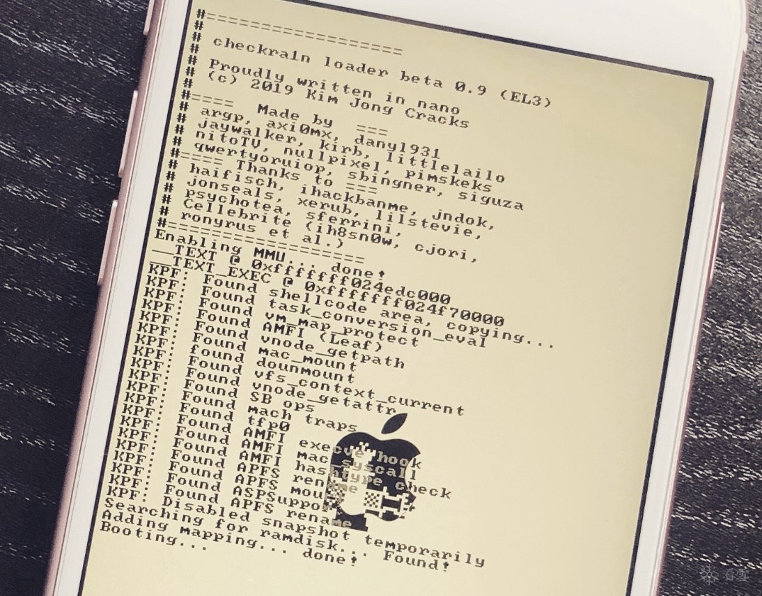

One of the things checkra1n does during the jailbreaking process is display a series of debug messages on the phone’s screen to let the user know about the progress of the jailbreak, and allow them to see what went wrong in the event of the jailbreak failing.
These debug messages are written to the display over the top of the standard boot screen. I was intrigued by this and started to wonder how the checkra1n team had implemented it. I heard some phrases thrown around online mentioning the use of a “framebuffer” and that the jailbreak tool was somehow “writing” to it.
So I set myself the challenge of figuring out how this worked and how I could replicate this in order render some characters on the screen by directly manipulating the pixels.

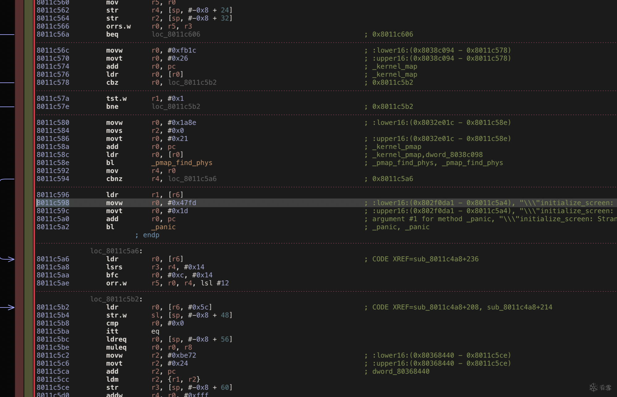

My first thought was to see if there was some kind of framebuffer symbol within the iOS kernel.
I opened a decrypted kernelcache file (for this, I’m using an iPhone3,1 iOS 7.1.2 kernel) in Hopper disassembler and searched for “framebuffer” but no luck :(

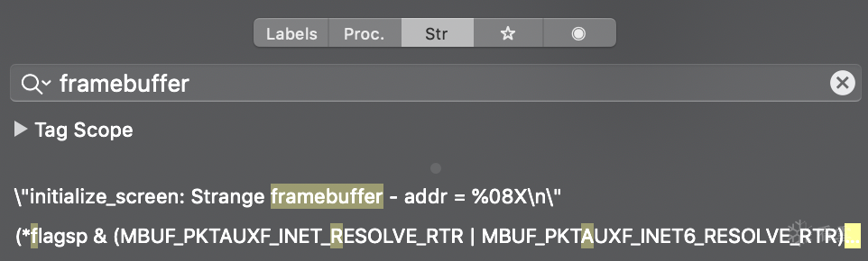

Despite not finding any symbols, Hopper did find a string containing “framebuffer”:
This string appeared to be some kind of debug message coming from the function initialize_screen. I went to the XNU source code to confirm this function actually existed and found it in the file e82K9s2c8@1M7s2y4Q4x3@1q4Q4x3V1k6Q4x3V1k6Y4K9i4c8Z5N6h3u0Q4x3X3g2U0L8$3#2Q4x3V1k6S2M7s2m8D9k6g2)9J5c8X3c8S2M7Y4N6A6L8W2)9J5k6s2S2F1N6g2)9J5c8X3u0D9L8$3u0Q4x3V1k6S2y4o6b7&6j5K6k6S2x3$3t1^5x3o6p5@1k6o6V1@1x3o6k6U0x3X3c8V1j5X3c8U0z5o6p5%4z5e0g2V1j5e0t1@1j5h3p5%4y4o6b7K6i4K6u0r3L8%4y4X3L8h3E0Q4x3V1k6U0L8$3&6K6L8$3I4W2i4K6u0r3N6X3W2V1k6h3!0Q4y4h3k6U0L8$3&6K6L8$3I4W2i4K6u0W2j5H3`.`..
Looking at the first few lines of code in this function it is clear that this function is responsible for setting up the device’s screen and assigning values for the width, height, colour depth etc.
The first argument to this function is a pointer to a PE_Video structure. I went to where this struct was defined (in 083K9s2c8@1M7s2y4Q4x3@1q4Q4x3V1k6Q4x3V1k6Y4K9i4c8Z5N6h3u0Q4x3X3g2U0L8$3#2Q4x3V1k6S2M7s2m8D9k6g2)9J5c8X3c8S2M7Y4N6A6L8W2)9J5k6s2S2F1N6g2)9J5c8X3u0D9L8$3u0Q4x3V1k6E0j5i4y4@1k6i4u0Q4x3V1k6H3k6i4S2H3k6i4u0@1i4K6u0r3M7r3g2^5M7r3g2J5N6q4)9J5c8Y4m8W2P5s2m8W2M7Y4c8Q4x3X3g2Z5) and found that it holds some information about the host’s screen, including the width, height, colour depth and a base address of where in memory the pixel data actually lies.

I followed the first XREF from the debug string I had found in the iOS kernelcache and landed in the following code:
If this code was part of initialize_screen then I’d have a chance at finding the address of this PE_Video structure in here.
There was no symbol for initialize_screen in the binary so I couldn’t tell for sure if the code I had found myself in was actually initialize_screen but a couple of observations between the disassembly and the source code left me pretty confident that it probably was.

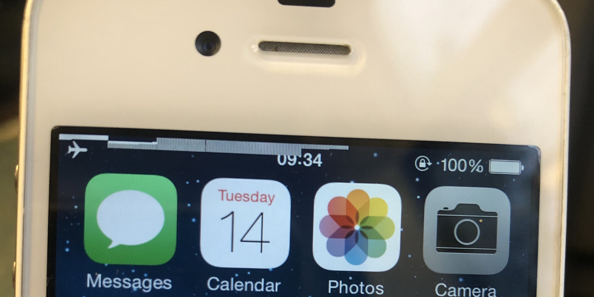

Now that we know exactly where the screen pixel values are held in kernel memory, we can move on to actually manipulating them.
I started by writing a small program that writes some black and white pixels to the screen, just to test that any changes I made to the memory actually affected what was being displayed on the screen.
The result looked something like this:
So now I had confirmed that this was indeed the framebuffer and changes to the memory resulted in changes to what we see on the device’s screen almost immediately.
Cool! Now we can look at actually rendering something potentially useful.

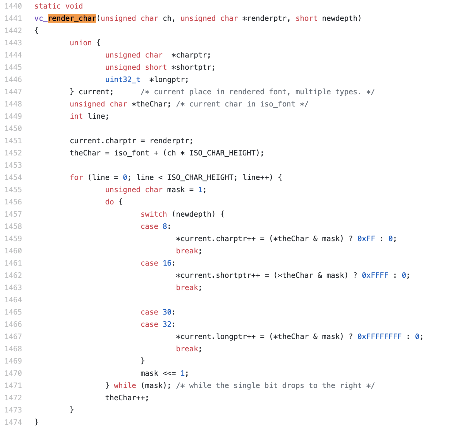

I did some more digging around the XNU source and found some functions that appeared to be responsible for rendering characters on the screen. One of these functions was vc_render_char.
This function follows an algorithm that renders a specific character on the screen. The font used here is the iso_font which is the same font that is used during the verbose boot mode on iOS and macOS. It is defined as a 256*16 byte array in the file a88K9s2c8@1M7s2y4Q4x3@1q4Q4x3V1k6Q4x3V1k6Y4K9i4c8Z5N6h3u0Q4x3X3g2U0L8$3#2Q4x3V1k6S2M7s2m8D9k6g2)9J5c8X3c8S2M7Y4N6A6L8W2)9J5k6s2S2F1N6g2)9J5c8X3u0D9L8$3u0Q4x3V1k6E0j5i4y4@1k6i4u0Q4x3V1k6G2M7$3k6E0K9#2)9J5c8X3y4G2L8Y4y4G2L8r3g2Q4x3V1k6A6M7$3!0Q4y4h3k6X3L8$3&6@1i4K6u0W2j5H3`.`..
The algorithm to render the characters works by taking a desired character — say ‘A’ — and using its ASCII code (65) multiplied by the desired character height in pixels and using it as an index into the iso_font array.
A series of bit-shifts and bitwise ANDs are then performed on the values to produce an output value. Depending on this output value, either a black or white pixel is written to the framebuffer.
I wrote some code to test if I could generate a character based on this algorithm, using the iso_font. The output was as follows:

Looking closely at the above output, you can see that the 0 characters create the shape of a capital A and the 1 characters act as a background.
To translate this to screen pixel data all we have to do is render a white pixel when the value returned is a 0 and a black pixel when the value returned is a 1.

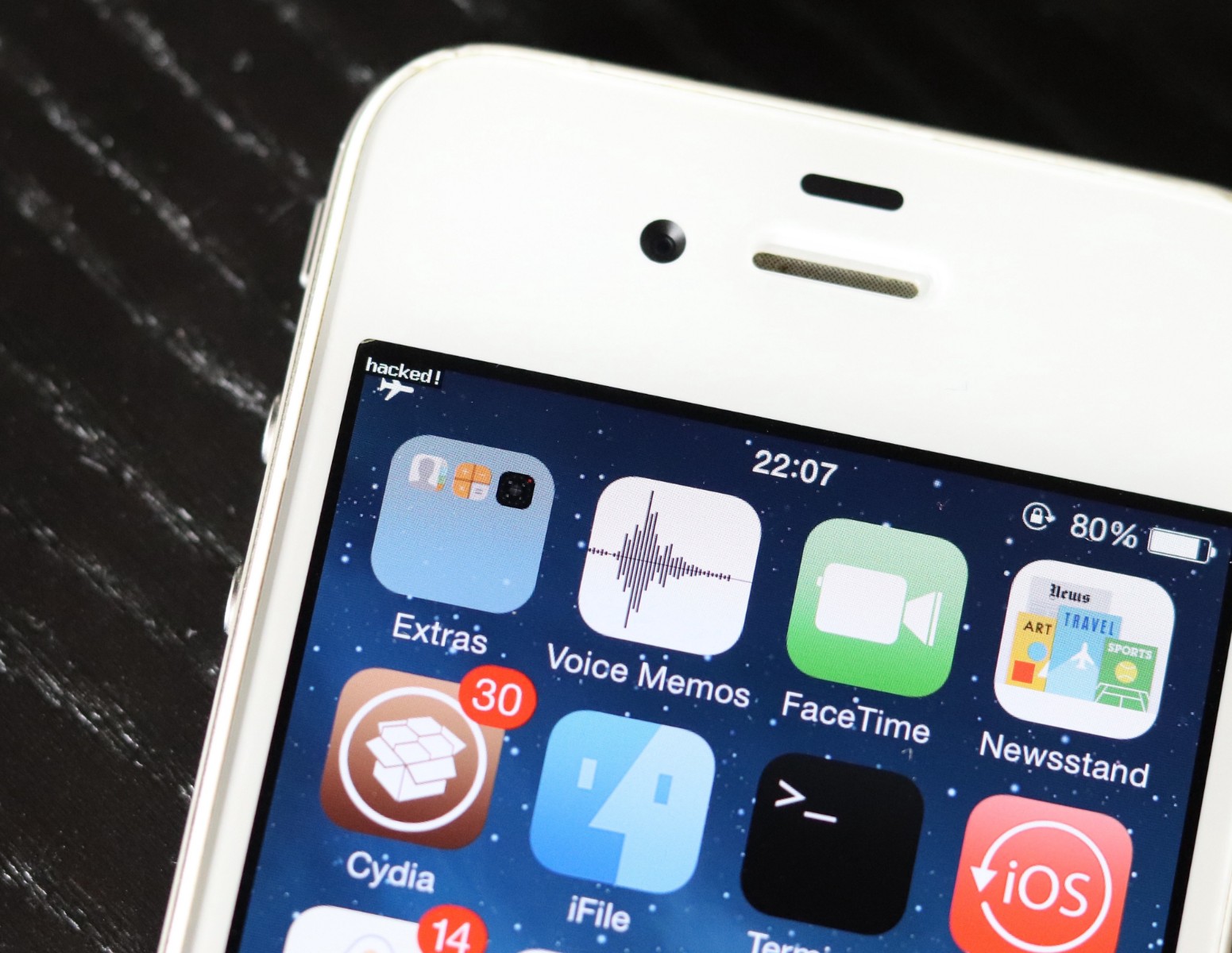

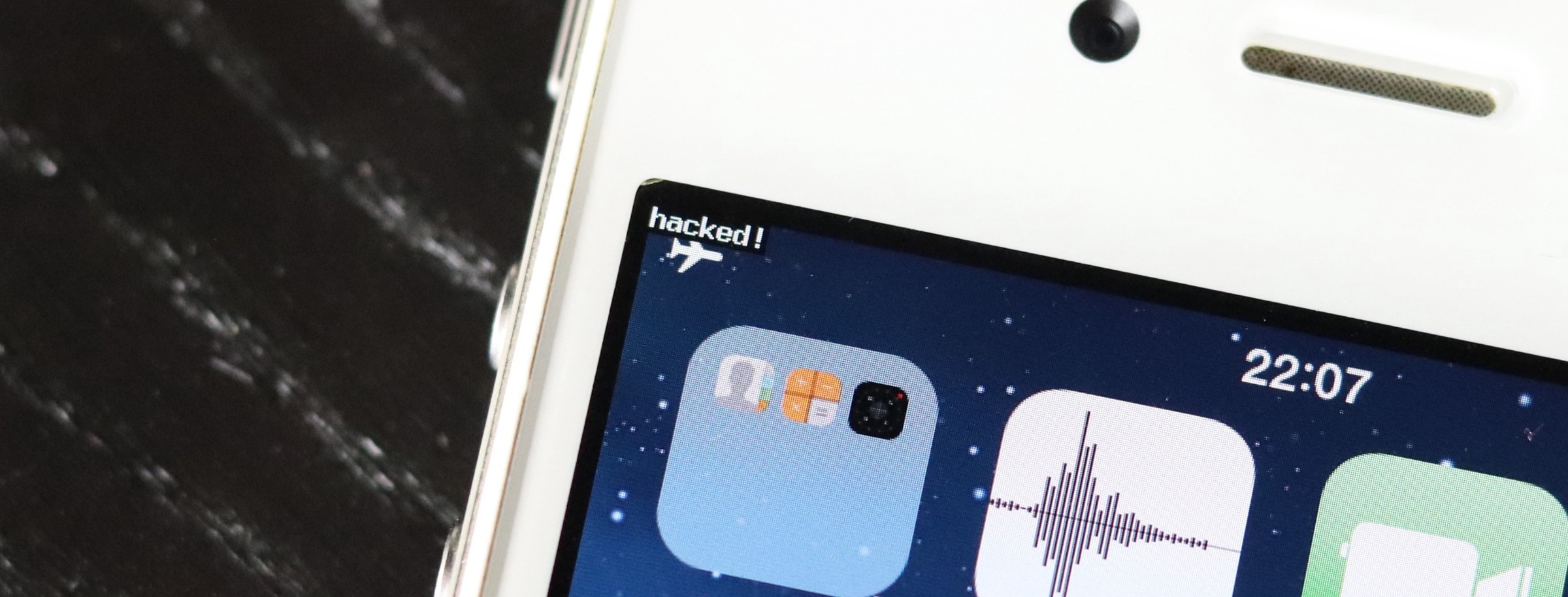

Final outcome
As a result of the above research, I managed write a program that allows me to render arbitrary text strings to the iPhone’s screen by directly modifying the framebuffer pixels!
I guess this research doesn’t have any real practical use, but it was a fun project to work on and the end result looks pretty cool ;)
