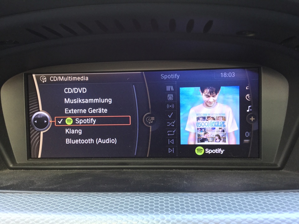

In 2016, a BMW joined my household, and I had my first taste of IDrive and BMW Connected Apps. Through some magic Bluetooth protocol, Spotify on my phone would be added to the list of music sources in the dashboard. Clicking into this entry showed a rich user interface, offering browse options to select playlists and to start radio stations based on the current song, far more interactive than the basic Bluetooth music controls.
Spotify App
Excitement
This immediately ignited excitement for the possibilities! Instead of being stuck with what apps are loaded on the car at time of manufacturer, the car can automatically be upgraded as support is added to the respective phone apps. Instead of needing to take my phone out of my pocket and stare down at the phone screen to switch music, I can use the tactile controller knob with the infotainment screen to safely control any app!

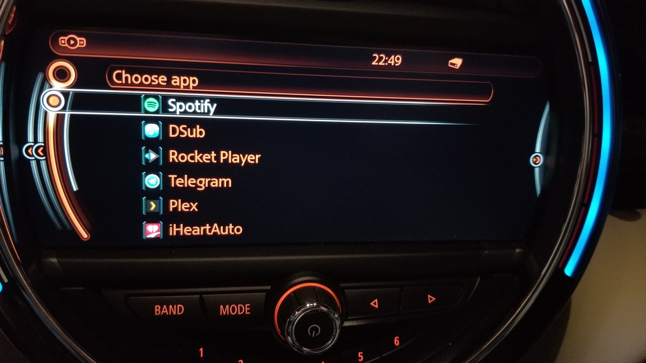

Other Available Apps

Other Apps
Additionally, BMW Connected for Android only shared a very limited selection of apps, compared to the available apps on iPhone: only Spotify and iHeartRadio, along with a basic Calendar app. Since I enjoy other music apps, I called up BMW Support and asked if I could get access to the BMW Ready SDK so I could build my own apps. They declined.

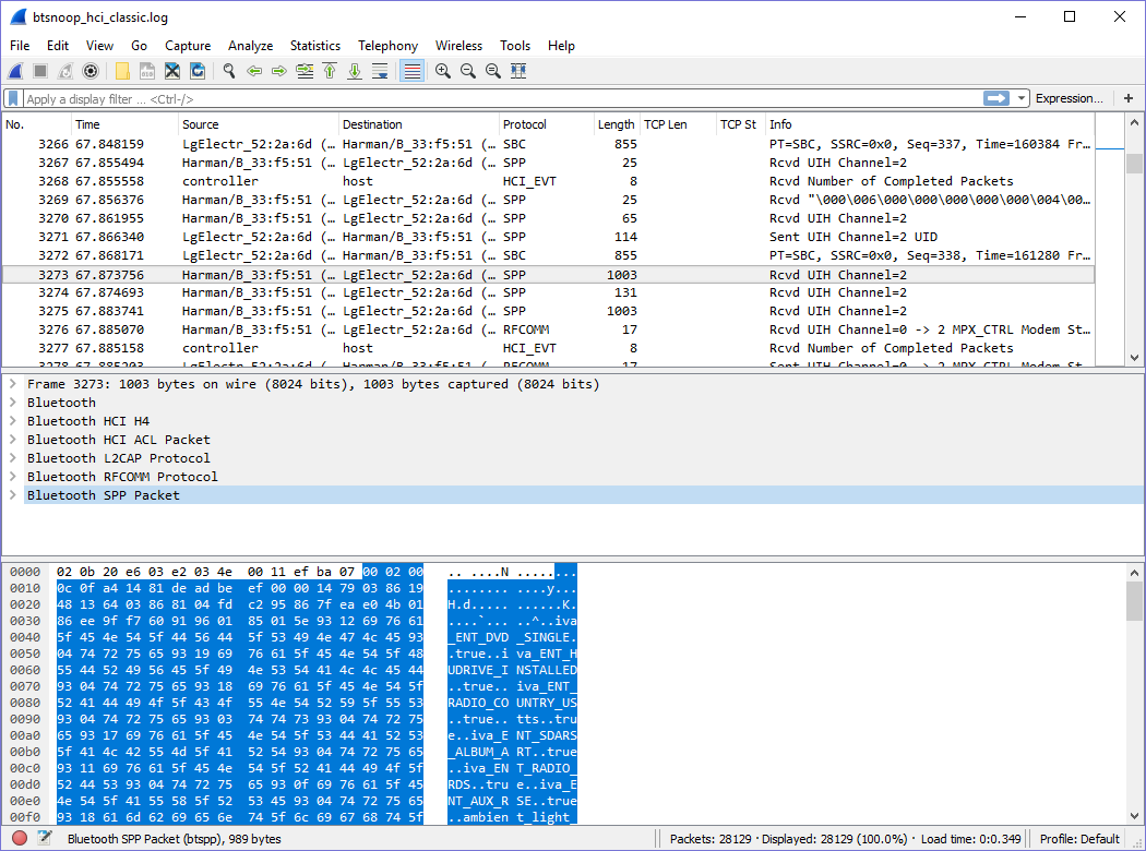

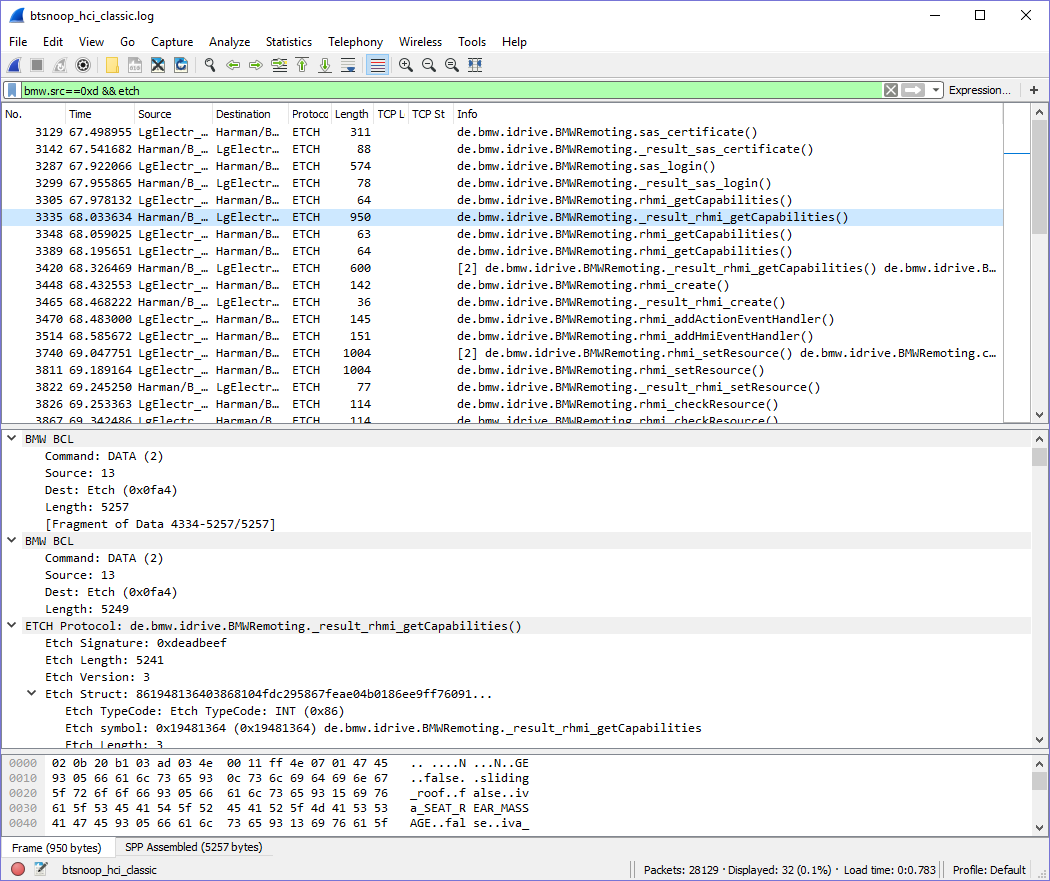

Oh hey look, Android has built-in Bluetooth Capture logging! I'll just record what the phone app is saying to the car and see what I find:
Bluetooth Capture
This SPP Protocol seemed to have lots of juicy information: I saw some X509 certificates, some XML data, some strings that look like song metadata, a ton of stuff!
BCL Multiplexing
I started noticing a pattern in the first bytes of most packets: The 0th byte was 0, the 1st byte was 1 or 6, the 2nd byte was 0, the 3rd byte was usually very low, and the next bytes were almost always 0x0FA4. I figured out that the next 2 bytes were the length of the remaining data, and the next 4 bytes of data were almost always 0xDEADBEEF.
I began writing a Wireshark Lua plugin to help me understand the data, parsing the first bytes as 4 16-bit values named Val1, Val2, Val3, and Length, and then outputting the remaining bytes of data.
It seems that this protocol is used to multiplex connections into a single Bluetooth serial socket, with Val2 being different connection IDs. With this field being parsed out in Wireshark, I could use display filters to follow an individual communication flow.

So I just run this list of names through my custom hasher, and give the resulting file to Wireshark, and get a beautiful protocol dump!
Wireshark Etch Decoding

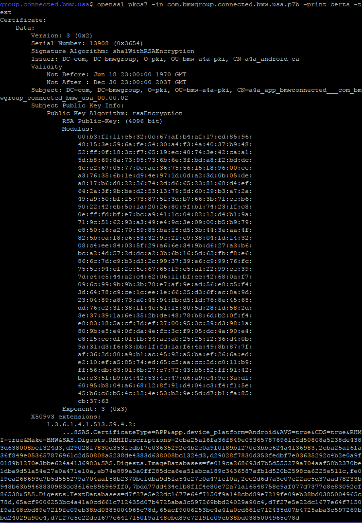

Car Authentication
When a new Etch connection is made from an app to the car, the first thing it does is send a PKCS7 certificate to the car. The car responds with a nonce, and the app is expected to respond with some authentication data.
The certificate is signed by a BMW CA, so there's no real way to get around that. However, these certs are easily available just by extracting files from app APKs, and the main Connected app includes about 10 of them.

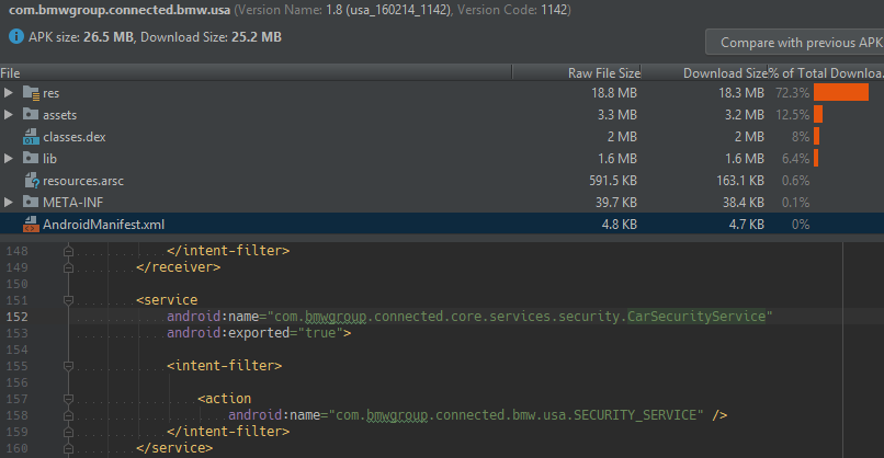

Turns out JVM bytecode is very easy to decompile: After you decompile the entire app into obfuscated Java files, you can load the entire thing into Android Studio and use its strong code search and refactoring tools to help navigate the code. Perhaps a clue can be found in com.bmwgroup.connected.internal.security.CarSecurityManager?
Yes actually, the code clearly shows how it uses Android Binder RPC to connect to a CarSecurityService object and exchange a challenge nonce for a challenge response. Additionally, this service is exported for any app on the phone to use.
Public Security Service
Some quick test code verified that this service gives back the same answer as the Wireshark captures. The service implementation is a small JNI wrapper around a native library that suspiciously contains some OpenSSL symbols. Just for fun, I also wrote my own minimal service implementation around this library for convenience.

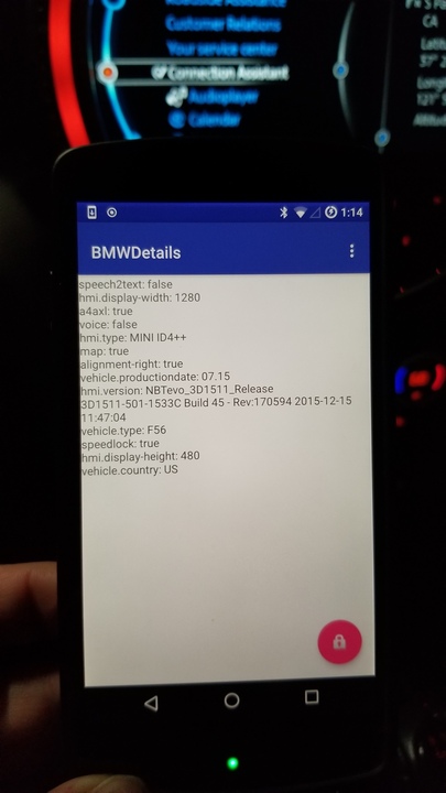

First Connection
Armed with this knowledge, I quickly built a test app to try to make my first connection to the car! One of the first things the official apps do, from looking in the packet captures, is call rhmi_getCapabilities to get a list of feature flags that the car supports, which seemed like a good first step to try to implement.
This involved implementing a BroadcastReceiver to listen for the car's connection announcement, acting as a client to the SecurityService to be ready for the challenge nonce, and actually instantiating the Etch proxy objects with the proper connection details.
After several trips between my desktop and the garage, I got a successful connection!

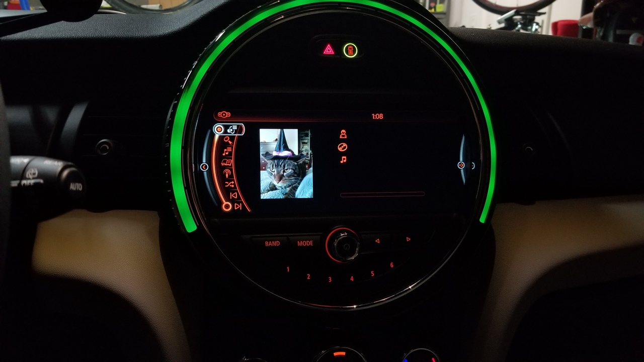

First App
So, as my first attempt to create an app in the car, I copied the initialization calls to send the remote UI resources, and then tested out the rhmi_setData call to try loading an image to the car:
Cat

My next experiment was to try to edit the widget layout sent to the car. However, this immediately failed, with the car rejecting the upload with an exception. Uploading the original artifact still worked great, however.
Looking closer, I found a list of SHA256 checkums in the authentication cert, and the original resources match up to those checkums. This means that I can't change any widget layout or the graphics packs. This is mainly a problem with the <entryButton> component, which is hardcoded to a specific icon from the graphics pack, so essentially any app that creates a RHMI app will show the app icon that belongs to the original authentication cert.
Certificate Restrictions

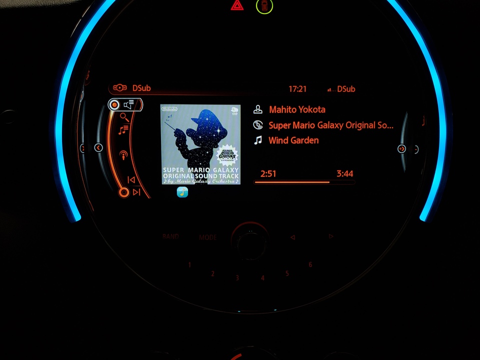

Armed with these basic building blocks, I set to work building my own music app for the car! Except I already have several excellent music apps on the phone, I would prefer to add those apps to the car instead of writing my own. Is there some way I could instead control the existing music apps?
Turns out that Android encourages music apps to implement a protocol called MediaBrowserService. By implementing this single API, the app automatically becomes available through Android Auto, Android Wear, and supposedly the Bluetooth stack. I could just act as another client to this interface, and implement the car as a frontend on top of this API.
Music Apps
Car App Implementation
This strategy made implementation relatively easy: I just needed to build a client to this MediaBrowserService, and whenever any metadata callbacks happen, update the car's labels with the appropriate information. Button callbacks from the car could run commands against the music app.
And then after months of polish, I have a music app with full browse and search support, which can control any MediaBrowserService music app:
Music App

  3. The car exchanges a login nonce for the client app to sign. In 2018, BMW did remove the exported service which allowed any app to ask for the answer to this challenge. While they can't remove it from the Connected Classic app, because the Play Store won't let them update it without updating the targeted Android API level, most users will be safe, running the new Connected app. However, unscrupulous attackers could just include the JNI library to generate their own challenge responses.
