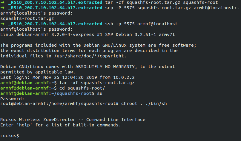

After extracting the firmware, we decided to emulate the firmware’s binaries in QEMU. This research was done entirely with system emulation. We purchase a R510 device only after we discovered all three vulnerabilities. In this dockerhub, we got pre-built QEMU systems, for the following architectures: armv7, armv6, mips and mipsel. These dockers really help us emulating and setting up different router setups. For this study, we used a docker that wraps an ARMv7 QEMU system that running a Debian kernel. We managed to run most of the user space code using this setup.
All you have to do is to pull and run our docker:
docker run -it -p 5575:5575 waveburst/qemu-system-armhf
Our container includes an SSH server, so we can copy the squashfs directory extracted from the firmware into our QEMU and chroot from there.
Done, we got a chrooted device emulation in 5 minutes.

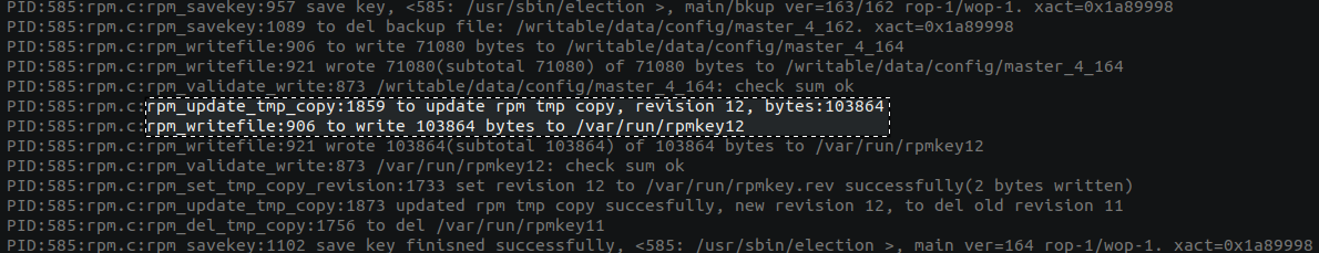

The above command showed us there was a symbolic link from /web/user/wps_tool_cache to /tmp directory. Since we ran R510 in a full QEMU system, we noticed there was some system logic stored in the /tmp directory. In particular, rpm.log was written as a part of system initialization. When examining this log file, we noticed that every day, rpmd created a backup file named /var/run/rpmkey with a new revision number.img
Fortunately, /var/run was also symbolically linked to /tmp/, so we could fetch this file as well. rpmkey contained some binary data. To examine its content, we used the strings command. strings output showed us two interesting fields: all_powerful_login_name and all_powerful_login_password. These were the device’s admin credentials in plaintext. Conveniently, the rpmkey revision number was stored at /var/run/rpmkey.rev. That helped us write a bash one-liner that retrieves the device’s credentials:
➜  demo num=$(wget -q -O - 192.168.0.1/user/wps_tool_cache/var/run/rpmkey.rev);\
         wget -q -O - 192.168.0.1/user/wps_tool_cache/var/run/rpmkey$num|\
         strings|grep -A 1 all_powerful_login
admin
mooncake

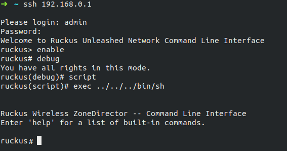

Since we could fetch admin credentials, popping a busybox shell would be our next step. The firmware includes a dropbear executable. With the admin credentials, we could enable it from the web interface, in case it was not already enabled. The dropbear server uses the same credentials as the web interface. However, it runs an alternative shell binary called ruckus_cli2. But we couldn’t get it to run any command we would like. Analyzing this binary with Ghidra showed there was a hidden command called !v54!, that should pop a busybox shell.
However, !v54! command requires the device’s serial number. Since we couldn’t necessarily know this serial number, a different approach was required. ruckus_cli2 supports a limited script environment, that can run some saved shell scripts. The exec command runs a script by calling execve system call with a given path. However, the exec command is vulnerable to path traversal, and can be used to pop a busybox shell:
That is the first way to own this AP.

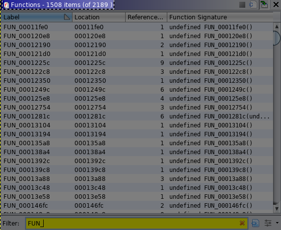

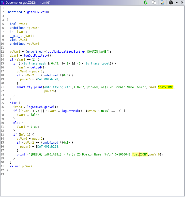

Ruckus left verbose log strings in the binary’s compiled code. The left log strings are for all levels (INFO/WARN/ERROR/DEBUG). They also contain the function name that printed the logline.
Thanks to the Ghidra scripting environment, we could search for these log strings and extract the associated function names. Then we could rename the default function names with the ones we found.
In the emfd case, it decreased the number of “un-named” functions by almost 50%, from 1505 to 874.
Note: Leaving sensitive information in log files is a common mistake in general, and particularly in embedded devices. With the help of our team member Vera Mens, we rewrote this script. It is now flexible enough to run on different binaries and search for function name patterns. This script may be useful in many projects and can be found on our github

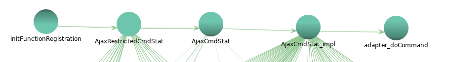

Determined by its name, AjaxRestrictedCmdStat() seemed like an excellent function to start reversing. But before we get into it, let us understand how Ajax requests work.

AjaxRestrictedCmdStat():
Reversing this function in Ghdira revealed that it expects the attributes xcmd='wc' and comp='zapd'. If the request is valid, it is passed to AjaxCmdStat(). AjaxCmdStat() handles all of the Ajax logic. It uses adapter_doCommand() to pass the request to a function called doCommand().
doCommand():
doCommand() is a large switch case function, that executes different commands based on the information form the request. The attribute cmd describes which functionality to run. With AjaxRestrictedCmdStat(), we could only pass wc to doCommand(). The wc command expects additional attributes - wcid, tool, server, client, and zap-type. If it gets all of them, it calls a shell script wrapper to execute a command called zap. Some attributes must match a specific value to get the command running. However, none of them pass sanitation. Therefore, we could pass any string with any length to the zap command.

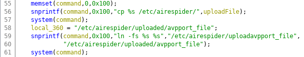

This attack scenario includes an arbitrary file write using the zap executable (CVE-2019-19836). It can create a new jsp page, that does not require authentication and is vulnerable to command injection (CVE-2019-19838, CVE-2019-19839, CVE-2019-19841, CVE-2019-19842).
Command injection:

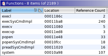

Let us understand how emfd executes shell commands. emfd uses 6 different functions to execute shell commands. Some of them are direct calls to functions in libc, such as system(), popen(), and execve(). Others call a wrapper that runs a shell script handler. This diversity in shell execution calls indicates that a bug, such as a command injection, might be feasible.
From the above functions, system() is the easiest one to exploit. It also appears to have a high reference count (107). Our goal was to find a function that calls system() in a way that we can control its argument. Here are 4 functions that met this criteria: cmdSpectraAnalysis() CVE-2019-19842, cmdImportAvpPort() CVE-2019-19838, cmdImportCatagory() CVE-2019-19839, and cmdPacketCapture() CVE-2019-19841. All 4 functions are reachable from doCommand() via AjaxCmdStat(), with the same mechanism described in scenario two.
However, they all depend on a request to /admin/_cmdstat.jsp page. This page checks for session authentication
➜  squashfs-root cat web/admin/_cmdstat.jsp
Delegate("SessionCheck", session["cid"], 'true');
var httpReq = request["headers"];
if(httpReq.HTTP_X_CSRF_TOKEN==session["cid"]
    || httpReq.HTTP_X_CSRF_TOKEN=='61a18965-f473-4f3b-97b1-4651d63b23fa'
    || session["isFactory"]=='true')
    Delegate("AjaxCmdStat", session["cid"]);
If the session is valid, all 4 functions should be vulnerable. We would like to focus on cmdImportAvpPort() for this article.
Decompiling revealed that the uploadFile attribute is obtained from the request XML, and inserted into the command variable without sanitation. Any command injection payload should work here.
