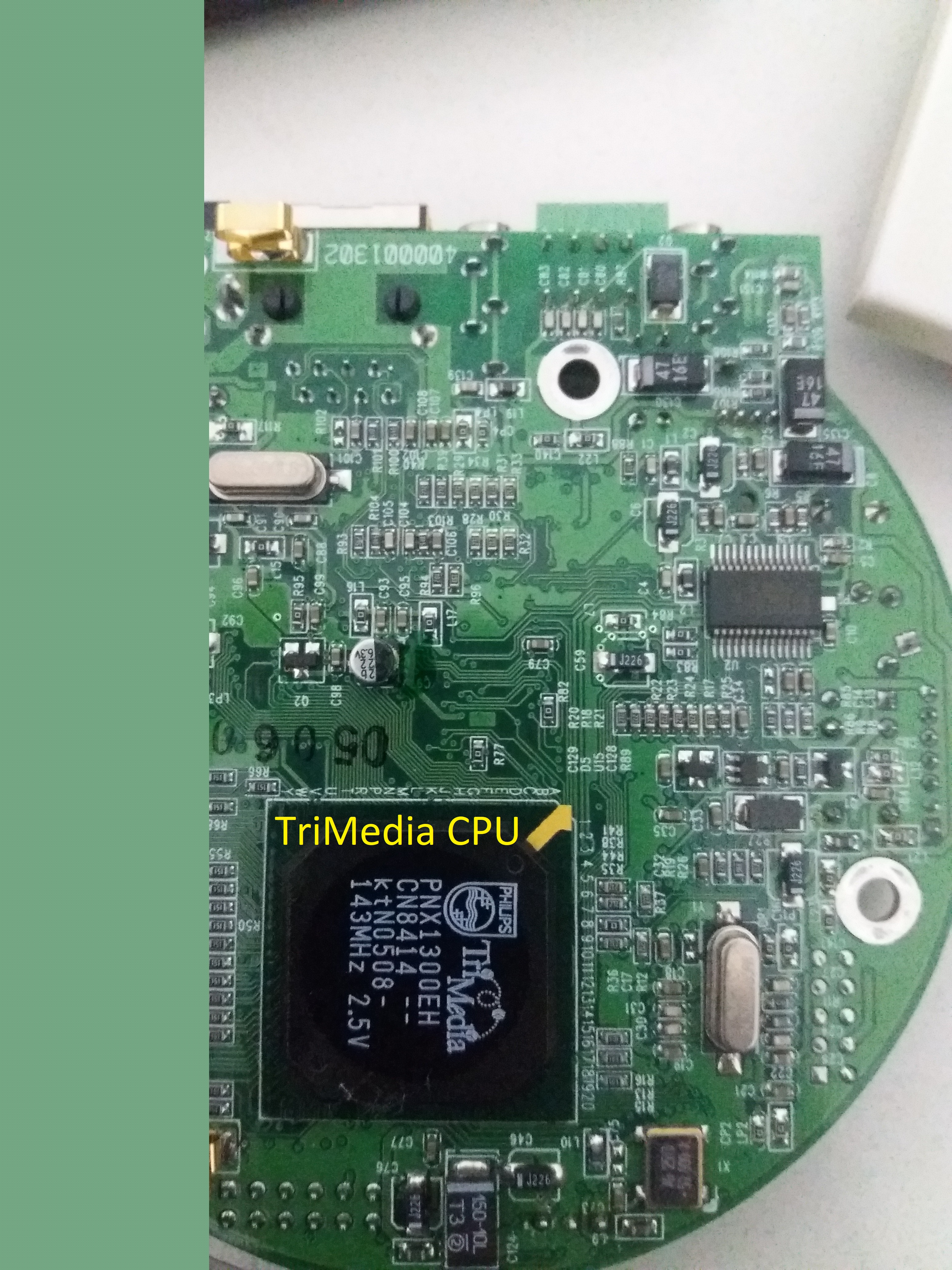

Some years ago, a co-worker, Francisco Falcon, and I did a presentation at hack.lu and Ekoparty about hacking IP cameras. That was my first contact with the embedded world. We had a lot of fun and from that moment on, IoT became a very interesting topic for me. That way, each time I got some device, I had to open it and study it.
Some months ago, I got a D-Link IP camera, specifically, a DCS-5300. It is an end user's IP camera, mostly for home users to watch what's happening in their house or work when they are not there. This is an old IP camera but it has something very interesting from the hardware perspective.
Usually, or at least from what I saw over the years, IP cameras have an ARM or MIPS CPU inside but this is not the case here. This model, and some others from the DCS-5xxx family, have a TriMedia CPU, a very old CPU. Why is this interesting? Personally, it is a new architecture for me and that's great because I can learn new things. However, there is very little documentation about TriMedia CPUs. From what I saw during this research, nobody has docs about it, nobody is allowed to speak about it, nobody is willing to share anything about it, everything seems to be a little bit "scary" and "obscure" about the TriMedia CPU. Why? Well, I really don't know. My bet is that as it is a proprietary CPU, originally from Philips, maybe it is a matter of NDAs.
In this post, we are going to talk about the first approach I took with the firmware analysis, then we'll see some analysis of the software and hardware present in the camera, and then, we'll do an introduction to the special CPU this camera has.

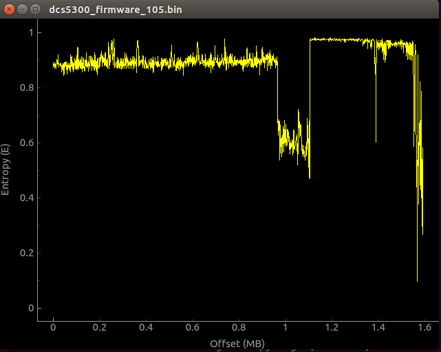

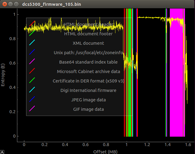

As you can see in the output, binwalk was able to recognize some HTML, XML and GIF files only. There are also some certificates of what seems to be some Base64 index tables, but there aren't any signs of a bootloader, kernel or filesystems. Generally, bootloader and kernel image tend to be at the beginning of the firmware's image file, but that's not the case.
Binwalk also identified something called "Digi International firmware" but we'll see later that is just a false positive.
For those who have not noticed, binwalk was capable of recognizing some files starting at offset 0xEEEC3, what about the rest? I assumed that the binary blob at the beginning of the file was encrypted/compressed or both, so I decided to do an entropy analysis using binwalk ("-E" and "-B -E" options):
  • Entropy analysis only
  • Entropy plus signature analysis
By looking at the graphs, we can see that almost the first megabyte of data has a very high entropy and looking at the variation, we can't totally be sure that it is only compressed or encrypted. Even though I tried to do a more exhaustive analysis of the entropy, I couldn't identify any known algorithm or cipher. At this point, I was sure I wasn't dealing with a common firmware image.

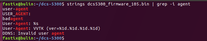

The last thing I tried at this point was to look at the strings (strings dcs5300_firmware_105.bin > output.txt) but I didn't find anything that could give me a clue about what I was dealing with.
So, I left this approach for a moment (we will see later what this binary blob has inside) and tried something different.

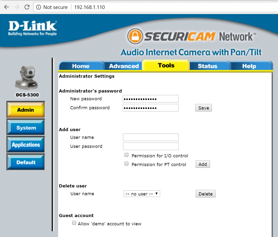

The next thing I tried was to start looking at different aspects of the camera in order to see if there was any vulnerability I could take advantage off in order to get access to it. At the end, we always want to get a shell. :)
I started by doing an nmap scan:
nmap -sV 192.168.1.0/24
Nmap scan report for 192.168.1.106
Host is up (0.0018s latency).
Not shown: 994 closed ports
PORT     STATE SERVICE        VERSION
21/tcp   open  ftp
23/tcp   open  telnet
80/tcp   open  http           D-Link Internet Camera
5001/tcp open  commplex-link?

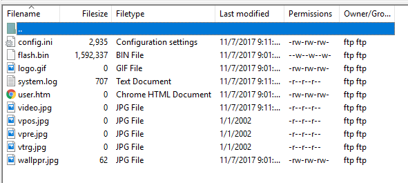

FTP server
When connecting to the FTP server (anonymous is the default connection type; we can set a user and password from the web interface), we get the following:
We get the root of the FTP server and we can't go anywhere from here. This is the only accessible folder for us. Also, as you can see, there aren't many files we can get. Most of the files are 0 sized.
We can see a file named 'flash.bin'. This file contains the file system of the camera but we can't download it, its permission is just 'w' (write), we don't have 'r' (read) access. However, we do have access to the 'config.ini' file. This file contains all the configuration from the camera, including the web interface credentials. So, assuming that we get a remote code execution vulnerability in the future, this file is the one we should get. Here's a little extract of the content of the 'config.ini' file:

The HTTP server gives us access to a web interface via a browser:
The default administrator's user is 'admin' with blank password. As you can see, you can change it in the web interface. Also, you can add different users and restrict them to use I/O and PT functionality. One interesting thing is that there is a 'guest' account available with user 'demo' and blank password. This guest account gives us access to the video stream via snapshots. Unfortunately (from an attacker's point of view), this account is disabled by default. However, some of the cameras I found in shodan.io had the demo account enabled.

The 'User-Agent' reported by the web server is the one used by Vivotek IP cameras, VVTK. Is it the same web server used by Vivotek? Well, I'm not sure but it could be an option ;p given that it shares almost the same CGI API that some Vivotek IP cameras. For example, this is the WEB API provided by a Vivotek PT31x4 IP camera (check the ' URL Commands of the Network Camera' section) and this is the one provided for the DCS-5300. do you see the similarities?

This is a picture of the front side of the biggest PCB:
In the above picture, we can identify the following components:
We have 128 MB of RAM, WiFi/Ethernet capabilities, 16 MB of Flash, a small video decoder and an EEPROM chip.
Then, this is a picture of the back side of the PCB:
On this side, we can see that we only have a big chip identified as Philips TriMedia PNX1300EH (32-bit processor). This is the reason for this post and we'll have a specific section dedicated to it.

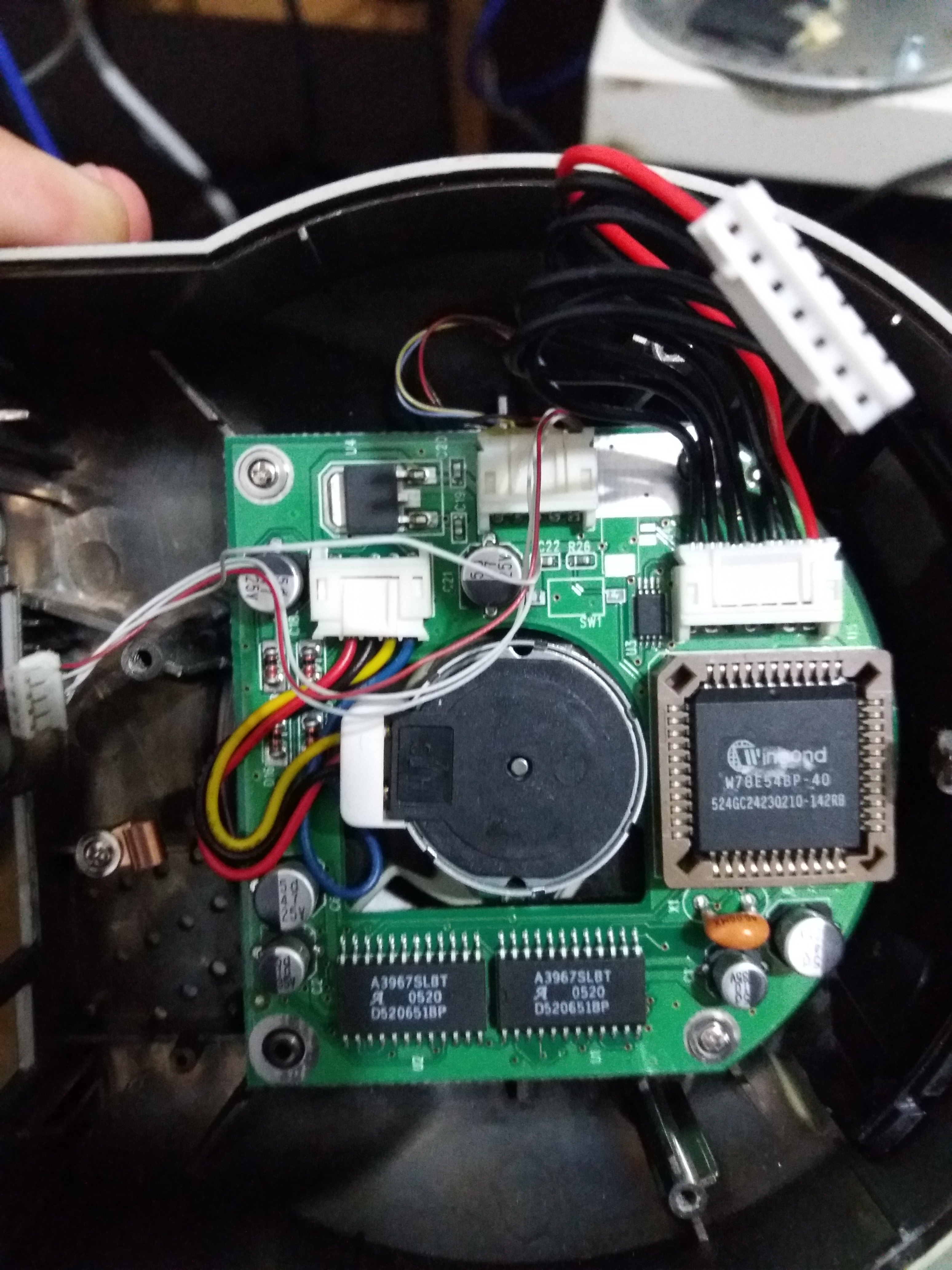

Finally, this is a picture of the second PCB:
On this side, we can see a Winbond W78E54BP-40 and two Allegro A3967SLBT chips. All this stuff is used to move the engine of the camera and blink some LEDs.
As you can see, most of the hardware in this camera is what anyone expects to find in a device of this kind. There isn't anything special about it except the fact that the CPU is not what you commonly see in the IP cameras sold today, most of them use ARM or MIPS CPUs.

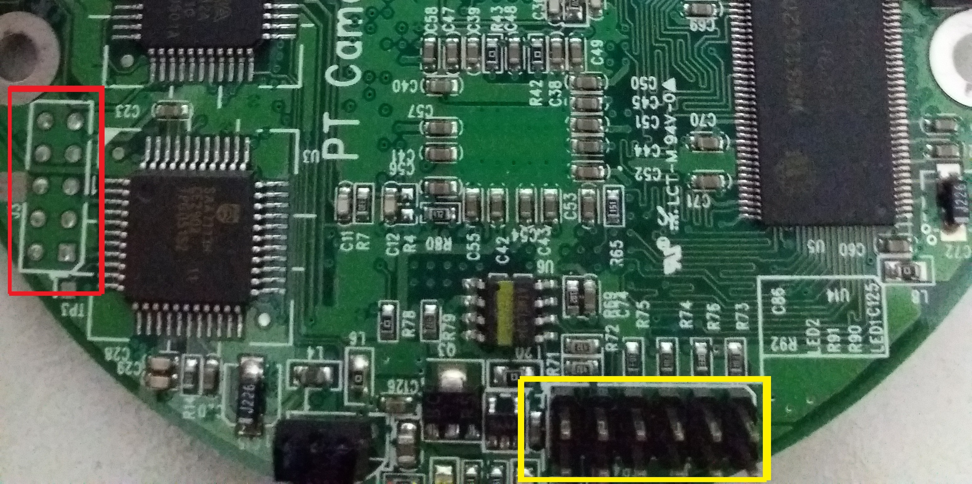

If you pay attention to the first picture, the one about the front side of the biggest PCB, we can see two interesting pinouts:
We have 10 pins marked with a red rectangle and 12 pins marked with a yellow rectangle. At first sight, both look promising but the 10 pins are a little bit far from the main CPU and there aren't visible traces to it. Instead, the 12 pins are really close to the main CPU and there are traces that seem to go in that direction. If we read the datasheet, specifically, the Chapter 18 "JTAG Functional Specification", we can see that the TriMedia CPU has a JTAG interface. These are good news!, but we have to identify the right pinout. This is not always an easy task, however, my first approach was trying to reverse engineer the pinout using a voltmeter as described here. After some time, I came up with the following results:
  • P1: Voltage fluctuation: 0,94 - 1, 14 - 2,x - 3,46 (TX?)
  • P2: Voltage fluctuation: 2,x - 3,46 (after a few seconds, remains steady at 3,46) (RX?)
  • P3/P4: Fixed voltage: 3,29
  • P5/P7/P11: Voltage fluctuation: 3,27 - 3,29 - 3,30
  • P9: Fixed voltage: 1,79
  • P6/P8/P10/P12: GND
Even though we got some information about the nature of the signals, we cannot get too much detailed information with a voltmeter in this case. The right tool we need in this case is an oscilloscope. With a scope you can check the basic nature of a signal (VCC, GND, Pulled-up line, numeric signal) and guess its parameters (max voltage, frequency, etc). At that moment, I didn't have that tool in my hands, I was armed with only a voltmeter and a Bus Pirate. Even though it's possible to build a cheap oscilloscope using a Bus Pirate, the bandwidth and sampling rate aren't good (5720 samples per second; in practice, gives a maximum measurable frequency of about 1kHz). At the end, in order to continue with this work, I bought a PicoScope 2204A but that will be a subject for another post.

In this post, I'm going to refer, specifically, to the TriMedia PNX1300EH microprocessor. Hopefully, all the information provided here can help you to research other processors of the same family.

Another good source of information, although specifically about JTAG research, is 417K9s2c8@1M7q4)9K6b7g2)9J5c8W2)9J5c8X3S2S2j5$3E0A6L8X3N6T1N6r3u0#2M7$3W2F1k6i4y4K6K9s2g2T1i4K6u0W2N6$3!0J5k6s2m8J5k6i4y4K6i4K6u0W2j5$3!0E0. Even though the blog is not available anymore, there are still some copies stored in web.archive.org [10] [11] [12]. This guy did an excellent work reversing 2Wire routers, which are based on TriMedia CPUs, and creating some excellent tools as 2wiglet (based on urjtag, a JTAG wiggler tool for 2Wire routers and tm32dis), a TriMedia disassembler for the TM32 family.
Now we are talking about JTAG, in a previous section, I mentioned that there is a JTAG PCI debugger for TriMedia CPUs offered by Monument Data System. There also exist an official JTAG debugger offered by Philips but it has some peculiarities. Quoting asbokid:
The TriMedia JTAG tools are designed to work only with a proprietary JTAG cable. The ‘cable’ is actually a sophisticated piece of programming equipment. It is a USB device that connects to the PC via a NetChip NET-2282 peripheral controller. The programmer boots from its own EEPROM and is driven by a Philips PNX1502 CPU with NOR flash and DRAM memory.
