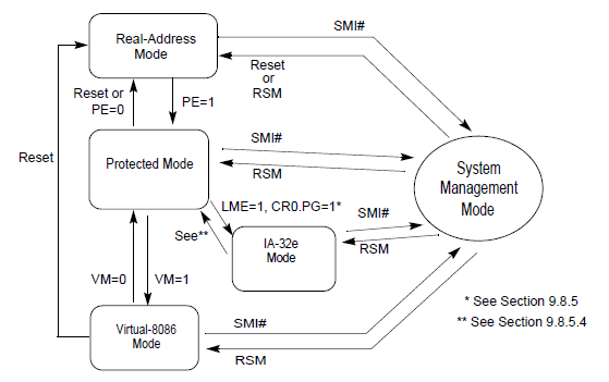

System Management Mode (SMM) is an Intel CPU mode. It is often called ring -2 as it is more privileged than the kernel or the hypervisor. SMM possesses its own memory space, called SMRAM, which is protected from access by other modes. SMM can be seen as a "secure world" not dissimilar to Trust Zone on ARM. However, its initial goal was not to provide security features but to handle computer specific requirements such as the Advanced Power Management (APM, which was replaced by ACPI). Today it is also used for protecting write access to the SPI Flash which contains the UEFI code.
mode_intel.png "Transitions Among the Processor’s Operating Modes" from the Intel Manual
As can be seen in the previous schematic, SMM can be reached from any "normal" modes. SMM also supports 16bits, 32bits and 64bits, which makes it a kind of duplicate of all the other modes. The transition between the normal modes and SMM is made when a System Management Interrupt (SMI) is triggered. When this happens, the processor switch to SMM: it will first save the current state of the CPU to a memory zone called the "Saved State" (necessary for being able to restore it later on) and then change the context including the instruction pointer for executing code in the SMRAM.

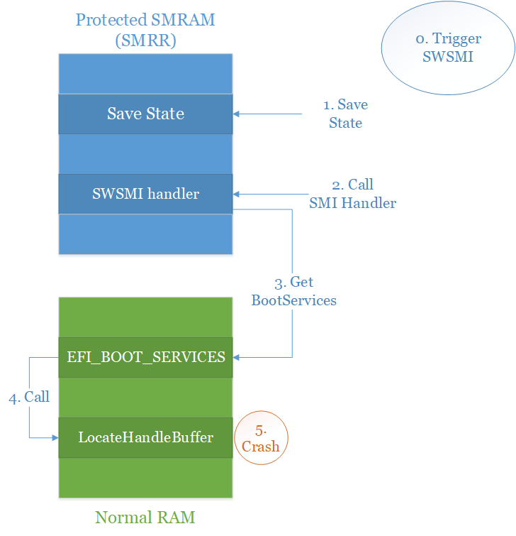

At this point if we try to trigger the code of the 0x3E00 handler with the callout of SMRAM the following will happen:
Triggering the callout
  1. We trigger the SWSMI with the correct number, the correct values in RSI and in memory for reaching the callout.
  2. The CPU will save the current state somewhere in SMRAM.
  3. Some code will be executed (including switching to 64bits) and our SWSMI handler will be called.
  4. The 0x3E00 handler will search the EFI_BOOT_SERVICES.LocateHandleBuffer function pointer in memory.
  5. And call the function.
  6. And then... it will just crash. Because SMM_CODE_CHK_EN is activated the call to code in normal world will never be executed, and so the original code without any modification does not even work.

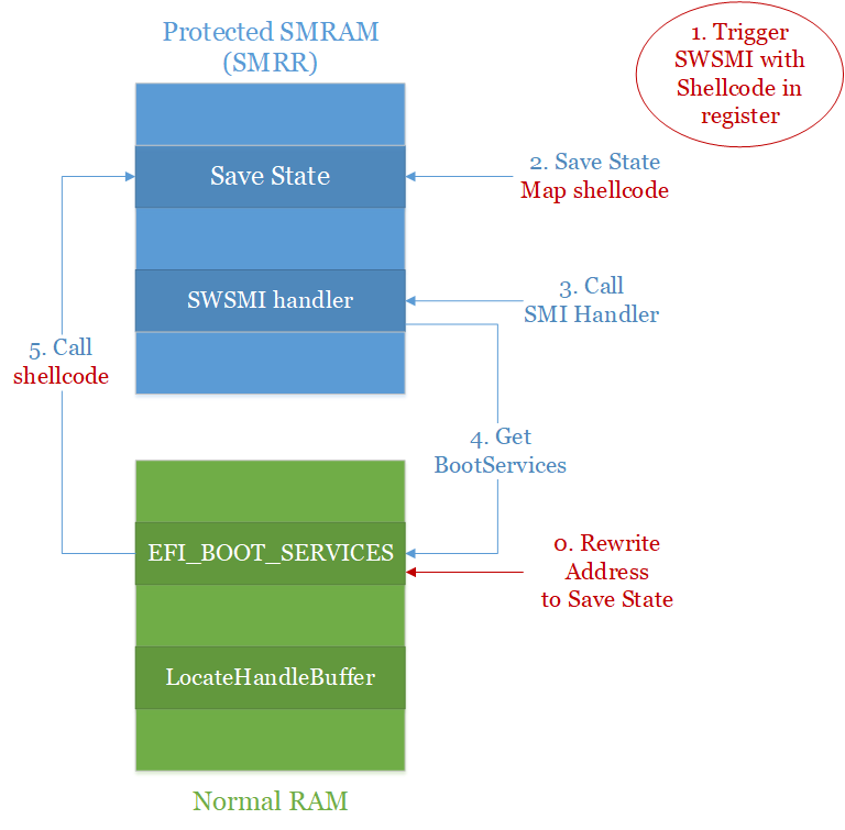

At that point the idea is the following:
Bypass of CodeChk idea
  1. First we rewrite the address of the LocateHandleBuffer in the EFI_BOOT_SERVICES structure with the address where our registers are located in the shellcode.
  2. Then we trigger the SWSMI with our shellcode stored in the registers. We still have to comply with all the conditions necessary to call our handler, but it will leave us way enough space for our shellcode.
  3. The CPU will then save our state in SMRAM mapping our shellcode for us.
  4. Our SWSMI handler will be called, himself calling the 0x3E00 handler.
  5. The function pointer for EFI_BOOT_SERVICES.LocateHandleBuffer will be fetched, but instead the address in the saved state will be retrieved.
  6. Our shellcode will be called and as the saved state is located inside the SMRAM, SMM_CODE_CHK_EN will not be triggered.
This idea is pretty simple and allows us to map our shellcode inside the SMRAM without being dependent from the firmware's code. Sadly there is a little problem with it: we do not know SMBASE which is used for computing the base address of the saved state.

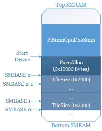

Getting the value of SMBASE has been a classical problem for exploiting SMM vulnerabilities since quite some time. Usually there are three main techniques for retrieving it: you can guess it, you can bruteforce it or you can read the MSR IA32_SMBASE which contains its value. The first two techniques have a huge probability of making the computer crash and sadly the IA32_SMBASE register can only be read from SMM creating a chicken and egg problem. Because of this I started to look for a better technique which would allow to get the SMBASE reliably and without the control of the hardware.
The SMBASE is initialized in the PiSmmCpuDxeSMM driver, this driver is open-source and available in edk2. When initializing the SMBASE the first thing it does is calculate the size necessary to reserve. Because there needs to be a SMBASE per CPU it is not enough to reserve 0x10000, but for RAM space optimization the driver avoids reserving that much memory per CPU. A TileSize is calculated in the driver for determining how much the SMBASE should be shifted, while the calculation is made dynamically in the driver in practice it is always shifted by 0x2000 bytes. We now know the position of the SMBASE compared to each other and that 0x10000 + TileSize * (number_of_cpu - 1) bytes of memory will be reserved.
To reserve the memory, the driver uses a wrapper on the SmmAllocatePages function and does not specify a particular address where to map this memory. By default, SmmAllocatePages will first try to look in a freelist and without result will take the highest available address. At that point of the boot there has been no reason to free a chunk of memory that big, meaning we can safely ignore the freelist. The last interesting point about SmmAllocatePages is that it is also used for mapping SMM drivers, and when the allocation for the SMBASE is done we know that the last driver allocated is the PiSmmCpuDxeSMM driver. At that point we know that the memory look like this:
Memory layout around the SMBASEs
We still do not have SMBASE but we start to have a good idea of what is around it, and it happens that PiSmmCpuDxeSMM registers a normal world protocol:

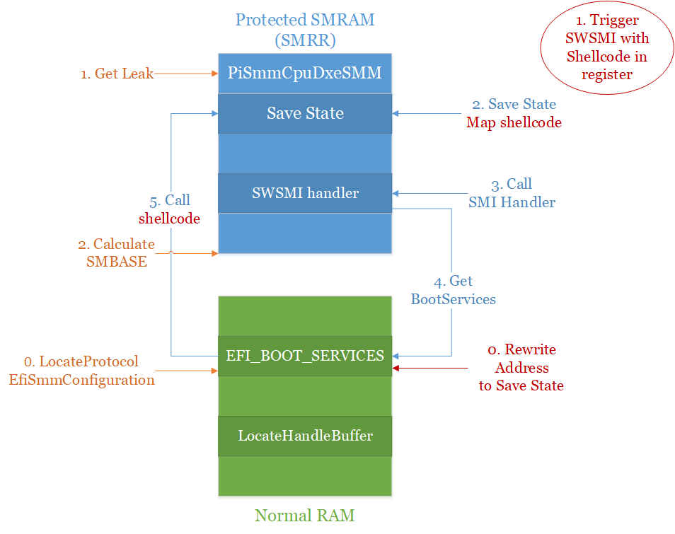

At this point we have everything needed for the exploit:
Full steps of exploitation
First we need to get the address of the saved state:
  1. Use the EFI_BOOT_SERVICES.LocateProtocol function for retrieving the EfiSmmConfigurationProtocol.
  2. From the protocol we get the leak in the PiSmmCpuDxeSMM driver.
  3. Which allows to calculate the SMBASE and deduce the address of the saved state where our shellcode will be.
Then we need to trigger the exploit:
  1. We start by rewriting the address of the EFI_BOOT_SERVICES.LocateHandleBuffer function with the value we just calculated.
  2. We trigger our SWSMI with our shellcode stored in the registers.
  3. The CPU will map our shellcode at the address we have calculated before.
  4. The SWSMI for SmmOEMInt15 is called and in particular the 0x3E00 handler.
  5. While trying to get the LocateHandleBuffer address, it will retrieve the address where our shellcode has been mapped.
  6. And finally our shellcode will be called giving us code execution in SMM.
