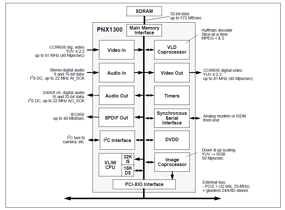

The TriMedia PNX1300EH CPU
I won't go into a very detailed description of each component on the CPU in this post because it makes no sense, if you need more detailed information, please, read the corresponding datasheet section. However, I'm going to dedicate some words to the parts that I think are the most important when it comes to reverse a TriMedia processor.
This processor has a maximum speed of 143-MHz and it works with 2.5V. Its core, called DSPCPU, is a general-purpose 32-bit CPU that also implements some media standards such as MPEG-1 and MPEG-2. The following is a block diagram of all the components of the PNX1300:
We already saw that the DSPCPU uses a VLIW (a simple explanation about this topic can be found following this link) instruction set, this allows five simultaneous operations to be issued every clock cycle. The DSPCPU has different 'issue slots', five in total, and each 'issue slot' has a different number of 'functional units', 27 in total, that can be targeted by each operation contained on each instruction. As each VLIW instruction encodes five independent operations, it is a little bit difficult to understand each instruction with respect to the others. It isn't easy to follow the control flow.
Regarding the register model of the PNX1300, it has 128 32-bit general purpose registers, starting from r0 to r127. Among these 128 registers, two that have fixed values; those are r0 and r1 that contain the integer values 0 and 1, respectively and are used mostly as boolean values, TRUE or FALSE. The programmer is not allowed to write to r0 or r1.
There is also a register for the program counter (PC) and four special registers: PCSW (Program Control and Status Word), DPC (Destination Program Counter), SPC (Source Program Counter) and CCCOUNT (Counts clock cycles since reset). The PCSW is mostly used as a register containing flags, like the EFLAGS and RFLAGS in 32-bit and 64-bit Intel platforms. It's important to remark that the PNX1300 CPU has a switchable bytesex (per unit). The bytesex switch is done by software by writing the BSX flag (bit size) into the PCSW register. This means that little and big-endian byte ordering can be found on the same execution. For example, load and store operations observe the BSX flag in the PCSW register in order to know if the operation should be done in little or big-endian order. If the BSX flag is equal to 1, then little-endian byte ordering is used. If the BSX flag is 0, then big-endian byte ordering is used.
The DPC and SPC are registers used for exception processing. The CCOUNT register, the only 64-bit register in the PNX1300, is used for cycle counting. It counts clock cycles since the last RESET event.

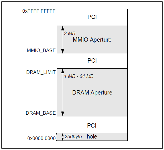

Regarding memory and MMIO, as said in the datasheet, the PNX1300 defines four apertures in a 32-bit address space: the memory hole, DRAM, MMIO and the PCI apertures. The DRAM is mapped from the address specified in the DRAM_BASE to the address in the DRAM_LIMIT registers. The maximum size is 64 MB. The MMIO is located from MMIO_BASE and is a fixed 2-MB size. Values for DRAM and MMIO are set at boot time by the BIOS. The memory hole is mapped from address 0 to 0xFF, thus is 256 bytes size. Finally, all the space not marked as DRAM, MMIO or memory hole is considered in the PCI aperture. The following is a diagram of the memory map in the PNX1300:

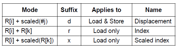

Another important thing to highlight is the addressing modes, these can be summarized in the following table:
In these addressing modes, R[i] indicates one of the general purpose registers. The scale factor applied (1/2/4) is equal to the size of the item loaded or stored, i.e. 1 for a byte operation, two for a 16-bit operation and four for a 32-bit operation. The range of valid 'i', 'j' and 'k' values may differ between implementations of the architecture. The 'i' and 'k' parameters can have a value between 0 to 127. The 'j' parameter can be between -64 and 63. For example, ‘ld32d(–8) r3’ loads a 32-bit value from address (r3 – 8).

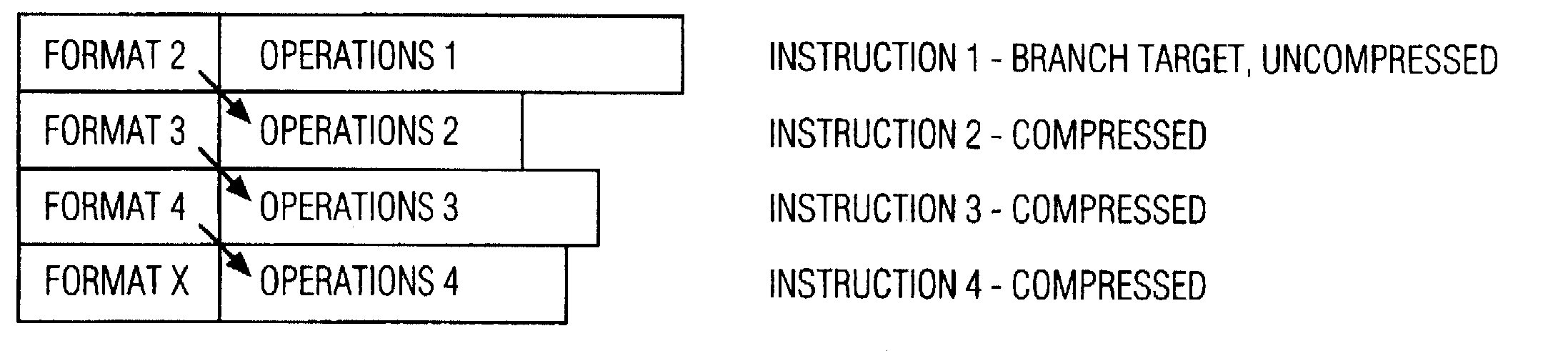

The first thing to know is that the execution flow is divided into "Decision Trees" (dtree). Each Decision Tree has a given number of instructions. A Decision Tree is the scheduling unit [5] or building block for a Trimedia VLIW core, it can be seen as a function in a high-level language. In the Trimedia ASM, the beginning of a dtree is indicated with the format bytes 0xAA02, these bytes are used to encode a branch target instruction, which is the only uncompressed instruction we can find in the Trimedia instruction set. These bytes are the starting point. Then, from a high-level perspective, there are a few steps required to finally decode the instruction: get the instruction length, get the operation size, unpack the operation and decode the operation. Remember that a Trimedia VLIW instruction is composed of 5 operations, each of these operations fills one of the 5 issue slots on the CPU. It is not mandatory for an instruction to fill all the slots and in those cases a NOP (no operation) is used.
One note about branches is that they are conceived more as an instruction rather than as an operation within an instruction. This is because all the compression techniques used by the Trimedia CPU eliminate all the NOPs, however, as the branch instruction is uncompressed it needs to fill the free slots with NOPs.
Another thing I asked myself was about the byte order. According to the 'Bit and Byte order' section, little-endian is the one used. Remember that Trimedia CPUs can change the bytesex during execution by setting a bit in the PCSW register.
At this point, you should have noted that the dtree starting point will always be a branch, uncompressed, thus it will be always 224 bits length.

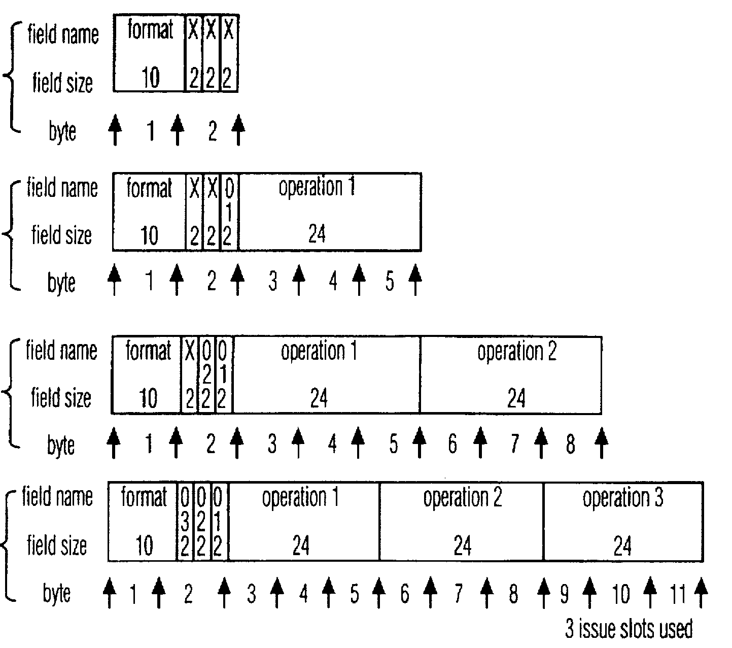

There is one more thing I didn't mention before, according to the documentation, on machines with more than 3 issues slots a second group of 2-bit and 24-bit operations part is necessary. Basically, as many things in the Trimedia ASM are bit fields and everything is byte aligned, in order to decompress all instructions, some padding bits are needed. The following diagrams, extracted from the US patent, show in a more graphical way, what I'm trying to explain:
The picture above shows how an instruction is composed of different operations (4 in total) and how each operation is preceded by its format fields. Note that the only uncompressed instruction is the branch.
The picture above shows a set of three instructions, each of which having its field name, field size and byte field listed.
The first instruction is only two bytes, there are 10 bits for the corresponding format bits and a group of 6 bits for padding. As the instruction which has no operations inside is considered as a NOP operation.
The second instruction contains a 24-bit operation part. In this case, a 2-bit group of bits is used marked with an O.
The third instruction contains two 24-bit operation parts and two groups of 2-bit each used as padding, again, marked with an O.
In the picture above, we have instructions with four and five operations, respectively.
The instruction with 4 operations has a first group of three operations, 24-bit part each, as we saw previously, with the corresponding 10 format bits and a group of 6 bits for padding. However, as one more operation was added, a group of 8 bits is added as format bits for the second group of operations (in byte 12) in which only the last two bits are used, marked with an O. Also, in this case, two byte extensions are added for the second operation and 1 byte extension for the fourth operation.
The instruction with 5 operation has a first group of three operations, 24-bit part each, with the corresponding 10 format bits and the 6-bit padding group. Additionally, it has the extra 8-bit format bit fields and a second group of two operations, 24-bit each. Additionally, each operation has 1 byte extension. The byte extension is placed at the end of the instruction.
