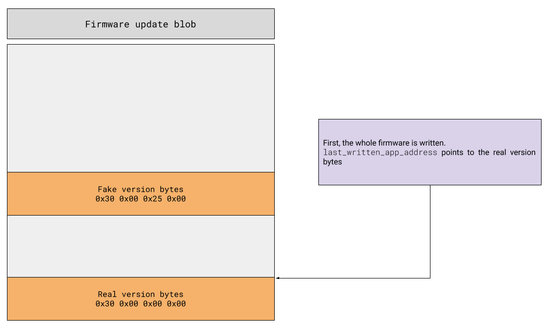

Solo firmware updates are a binary blob where the last 4 bytes represent the version. When a new firmware is installed on the keys, these bytes are checked to ensure that its version is greater than the currently installed one. The firmware digital signature is also verified, but this is irrelevant as this attack only allows to install older signed releases.
The new firmware is written to the keys in chunks. At every write, a pointer to the last written address is updated, so that eventually it will point to the new version at the end of the firmware. You might see the issue: we were assuming that chunks are written only once and in order, but this was not enforced. The patch fixes the issue by requiring that the chunks are written strictly in ascending order.
As an example, think of running v3.0.1, and take an old firmware - say v3.0.0. Search four bytes in it which, when interpreted as a version number, appear to be greater than v3.0.1. First, send the whole 3.0.0 firmware to the key. The last_written_app_address pointer now correctly points to the end of the firmware, encoding version 3.0.0.
Firmware downgrade step 1 Then, write again the four chosen bytes at their original location. Now last_written_app_address points somewhere in the middle of the firmware, and those 4 bytes are interpreted as a “random” version. It turns out firmware v3.0.0 contains some bytes which can be interpreted as v3.0.37 – boom! Here is a fully working proof-of-concept.
