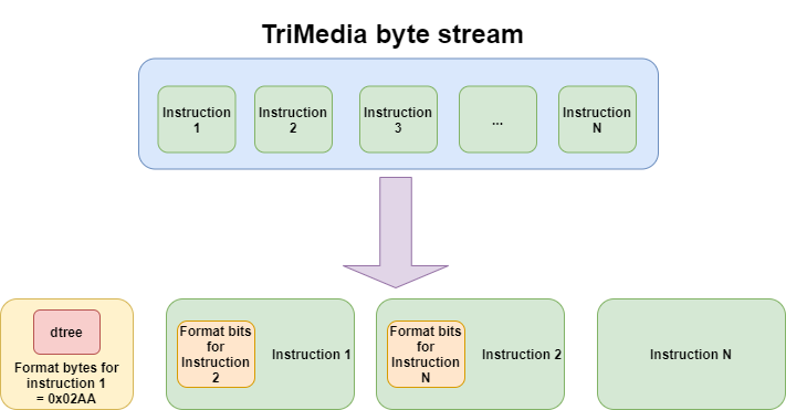

  8. a function in the TriMedia ASM starts with a dtree.
The following diagram demonstrates, in a general manner, how a TriMedia instruction is composed:

Now that we know the place where the extension bytes are, we can continue with the last operation needed to disassemble a Philips TriMedia instruction. The decoding operation is not complex but many decisions have to be made in order to decode the actual bytes. The input for the decode operation is a byte array containing the operation bytes calculated by the unpack operation.
Step 4 - Decode operation
The work of the decode operation is to get the byte array returned by the unpack operation and parse the bit fields which hold the operation code, operands, parameters, predicates, etc. I won't show each single case for each single operation type because it makes no sense to go through all of them but I'll use the first operation to show you some of the basic cases you can find. This will give you a basic idea of the whole process and if you are interested in the other cases, you'll just need to look at the code of the disassembler or the datasheet/US Patent mentioned in the posts.
