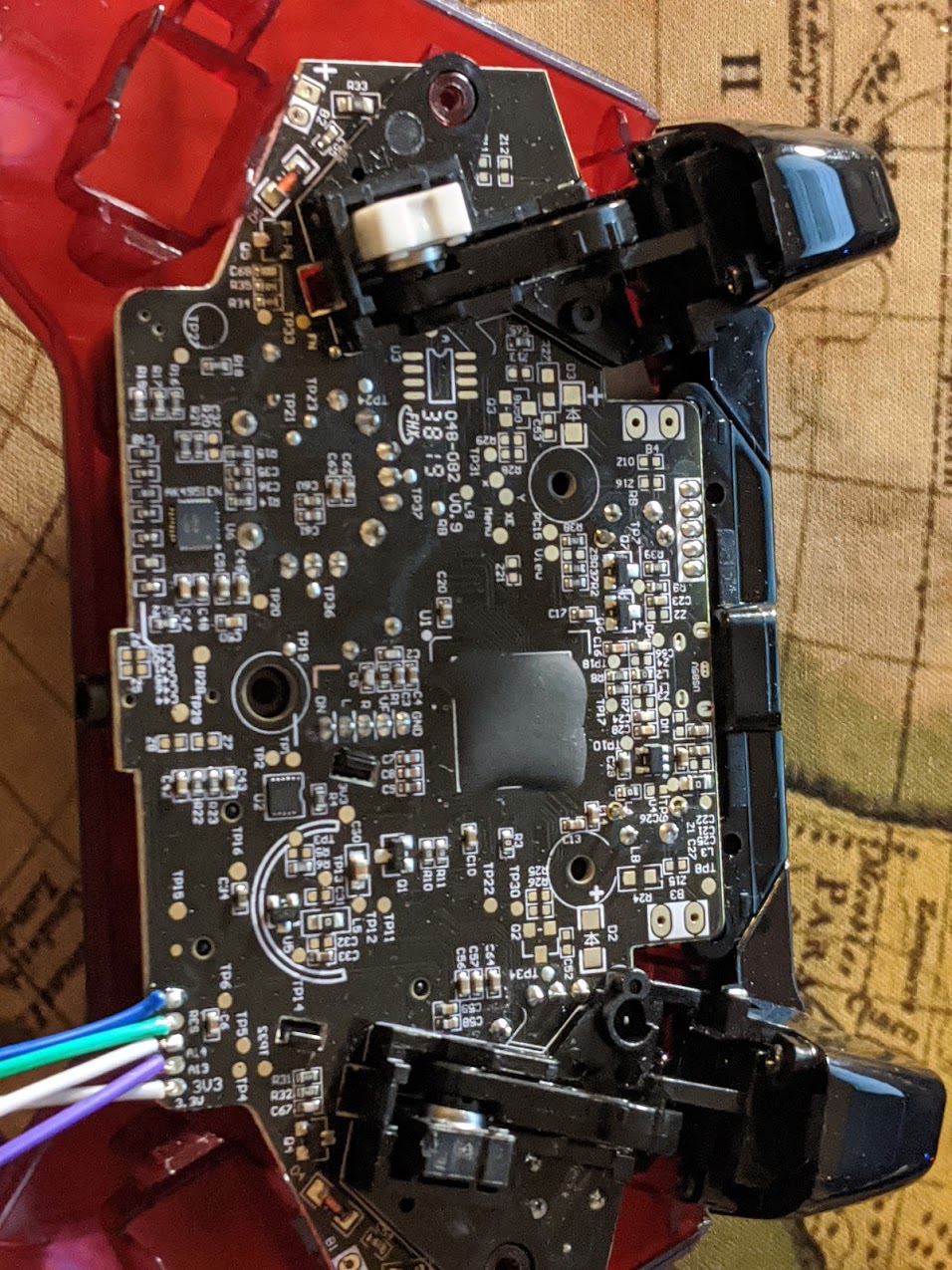

Opening up the case reveals the following PCB:
controller_pcb
Note that there really isn’t too much to see here, as the main chip is covered in epoxy. Luckily for us a lot of the test pads are labeled, but the labeled ones seem to be test points for various button presses, so there’s nothing exciting there.

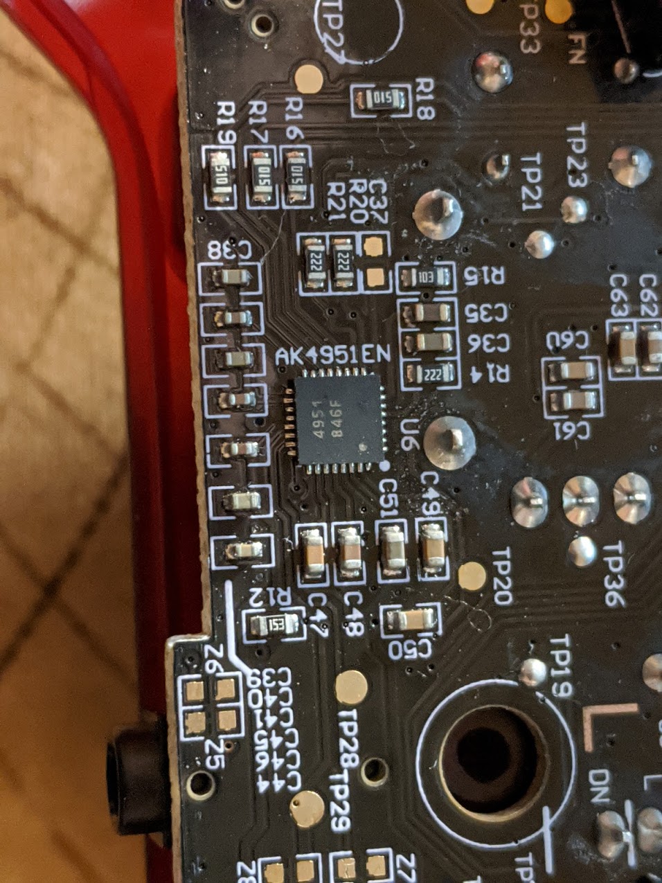

There is an IC labeled AK4961 towards the bottom of the board, but this is an audio codec chip. The datasheet can be found here. This chip is a low power 24-bit stereo CODEC with a microphone, headphone and speaker amplifiers.
Audio IC

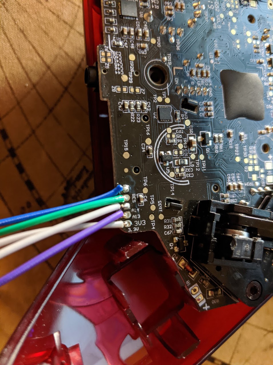

If we look to the right of this however there is a small grouping of pads with some silk screen labelling:
debug_pads
So we see 3V3,A13,A14,RES labeled in the silkscreen. This is worth taking a look at, and if you’ve read my previous post about the router teardown and discovering UARTs you may already have some ideas on how to proceed here. We’ll start by measuring the voltage of each pin with a multimeter:
Pin Value
0/NA 0 (GND)
RES 3.3V
A14 0.1V
A13 3.3V
3V3 3.3V
There was no fluctuation or modulation on RES, A14 or A13, so these must be for something else, but what? Given that one of the labels is RES (which likely stands for system reset) there is a good chance that there are JTAG or SWD headers.

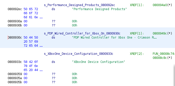

So at this point, we have the flash dumped, we can debug and single step through the firmware, but … can we reflash the MCU?
If we can locate the USB descriptor strings in the firmware image and patch them, we can use that as a visible method to determine if we can patch the firmware. Let’s load up the firmware in GHIDRA and see if we can find them, the firmware image can be loaded at address 0x8000000. We know that the firmware is loaded at 0x8000000 based on the datasheet, however if we did not have the datasheet this could be determined from OpenOCD by issuing the reset halt command and single stepping through the first instruction. Luckily, this firmware image is rather small and Ghidra makes quick work of it. The strings that were seen in the dmesg output can be seen in the screenshot below:
xrefs
Let’s do a simple patch with the product string, changing it to “Testing Firmware Patches”. The flash can be overwritten with the following commands in the OpenOCD telnet console:

  5. We write the patched firmware image, and restart the CPU, prompting the following to show up in dmesg
[54691.886194] usb 1-6.4: new full-speed USB device number 14 using xhci_hcd
[54691.992411] usb 1-6.4: New USB device found, idVendor=0e6f, idProduct=02a2, bcdDevice= 1.0f
[54691.992417] usb 1-6.4: New USB device strings: Mfr=1, Product=2, SerialNumber=3
[54691.992420] usb 1-6.4: Product: Testing Firmware Patches
[54691.992423] usb 1-6.4: Manufacturer: Performance Designed Products
[54691.992426] usb 1-6.4: SerialNumber: 0000AE38D7650465
[54691.998102] input: Generic X-Box pad as /devices/pci0000:00/0000:00:14.0/usb1/1-6/1-6.4/1-6.4:1.0/input/input28
Excellent - so we now have the firmware fully extracted and loaded into ghidra, as well as the ability to modify it as we see fit…now it’s time to write some macros. But it’s getting late and I almost missed the monthly post deadline for January so I think I’m going to wrap it up here!
