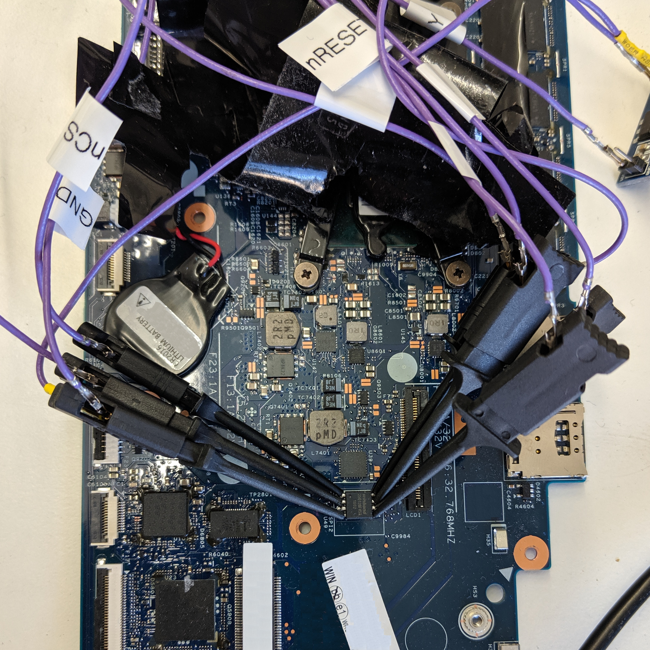

At heart, PCs are just large, powerful, embedded devices—and like most embedded devices they have flash chips that we
can dump and rewrite. The flash chip is usually the chip with the bulkiest package on the board. We quickly identified
the flash chip on our laptop's motherboard, and promptly attached it to a SPI flash programmer with some clips.
Flash chip with clips attached

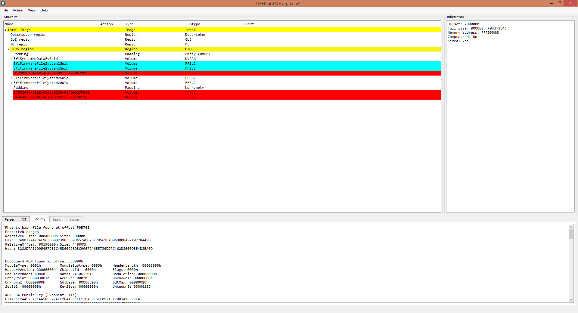

The flash's contents were formatted as an Intel image and could readily be parsed by UEFITool
Flash dump loaded in UEFITool
Intel flash images are divided into several regions. However the only region that we cared about was
the BIOS region. The BIOS region consists of several firmware filesystem volumes and an NVRAM variable storage area. We
could have just found the file responsible for showing the setup screen to the user and patched out the password
check, but that wasn't possible on this laptop because hardware-based firmware security was enabled.
In the image above, areas marked in red are protected by Intel BootGuard. Before the CPU can execute any instructions
the hash of the red areas is computed and then checked against a signature stored in the flash somewhere; the hash of
the RSA public key used to verify that signature is fused into the PCH during the OEM's manufacturing process. The
areas marked in cyan are protected by the OEM's code verification mechanism. The OEM has to implement it's own
verification mechanism on top of BootGuard, because BootGuard only protects the SEC and PEI phases. The DXE phase also
needs to be protected from modification. In most implementations, the cyan areas are hashed, and that hash is matched
against a hash stored in a file in the red area. Since everything in the red area is already protected by BootGuard,
another signature is not needed. However, no NVRAM variables can be protected because they're designed to be modified
by end-users.

Editing NVRAM Variables in Flash
At this point since we were unable to boot into anything except the boot menu, our only option for editing those NVRAM
variables was to write to them directly using our external flash programmer. We retrieved a fresh dump from the flash chip so we would only
modify the current state rather than revert it to an earlier state and potentially cause even more things to break. We
found the offsets of the variables in the flash using UEFITool. There is a header on each variable, so you need to skip
past it to get to the actual value of the variable. After editing all of the variables thqat were needed to change the options, we reloaded the
dump in UEFITool to verify that we didn't accidentally corrupt anything and that the value of the variables actually
changed. After that, we re-flashed it, hooked up the crossover cable, powered-on the board, and hoped for the best.
