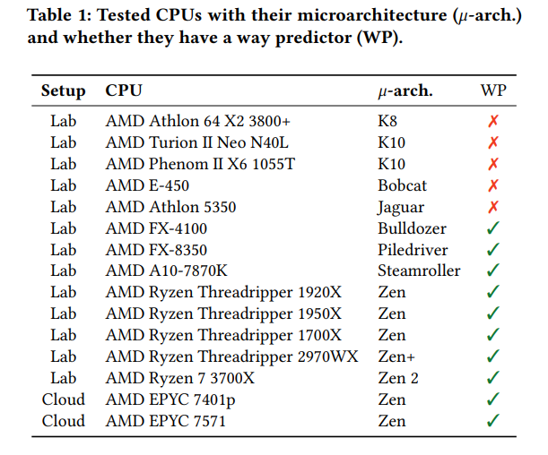

A new paper released by the Graz University of Technology details two new "Take A Way" attacks, Collide+Probe and Load+Reload, that can leak secret data from AMD processors by manipulating the L1D cache predictor. The researchers claim that the vulnerability impacts all AMD processors from 2011 to 2019, meaning that the Zen microarchitecture is also impacted. (PDF)

"We reverse-engineered AMD’s L1D cache way predictor in microarchitectures from 2011 to 2019, resulting in two new attack techniques. With Collide+Probe, an attacker can monitor a victim’s memory accesses without knowledge of physical addresses or shared memory when time-sharing a logical core. With Load+ Reload, we exploit the way predictor to obtain highly-accurate memory-access traces of victims on the same physical core. While Load+Reload relies on shared memory, it does not invalidate the cache line, allowing stealthier attacks that do not induce any last level-cache evictions."
(Image credit: u)
The researchers exploited the vulnerability via JavaScript run on Chrome and Firefox browsers, and also gained access to AES encryption keys. The exploit can also purportedly be used to penetrate cloud deployments in the data center. The paper suggests several possible remedies for the vulnerability through a combined software and hardware approach, but doesn't speculate on the performance hit associated with the suggested fixes. The researchers also noted that unlike the Spectre and Meltdown vulnerabilities, the Take A Way exploits only leak a "few bits of metadata," as opposed to providing full access to data (example of Meltdown exploit here).
