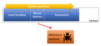

A canonical example of a stack buffer overrun is copying data from one buffer to another without bound checking (i.e. strcpy). If an attacker replaces the data and size from the source buffer, the destination buffer and other important components of the stack can be corrupted (i.e. return addresses) to point to attacker desired code.

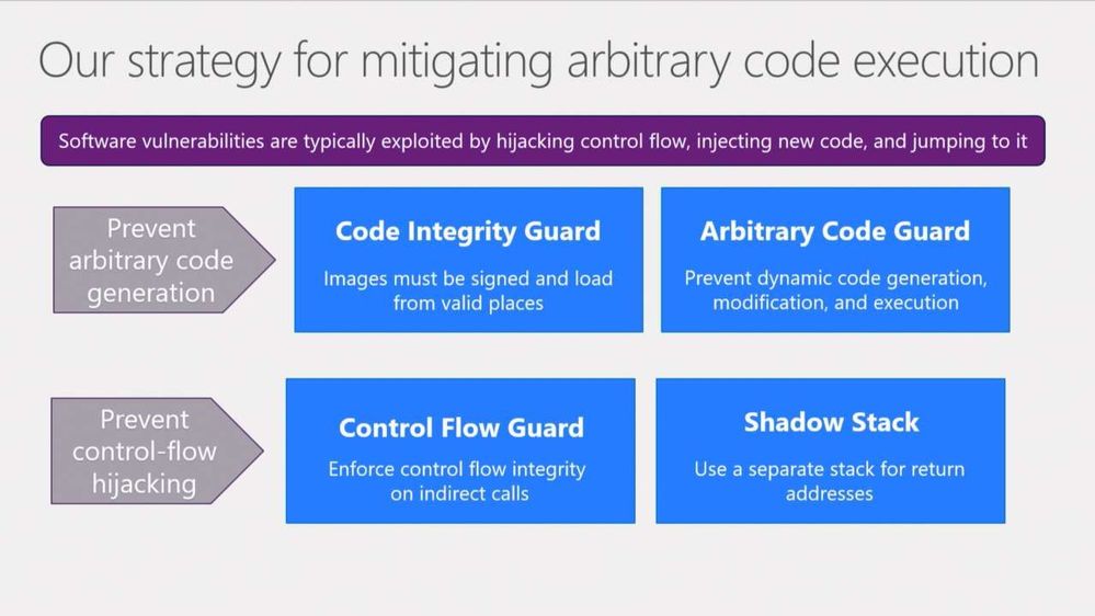

We frame our strategy for mitigating arbitrary code execution in the form of four pillars:
Code Integrity Guard (CIG) prevents arbitrary code generation by enforcing signature requirements for loading binaries.
Arbitrary Code Guard (ACG) ensures signed pages are immutable and dynamic code cannot be generated, thus guaranteeing the integrity of binaries loaded.
With the introduction of CIG/ACG, attackers increasingly resort to control flow hijacking via indirect calls and returns, known as call/jump oriented programming (COP/JOP) and return oriented programming (ROP).
We shipped Control Flow Guard (CFG) in Windows 10 to enforce integrity on indirect calls (forward-edge CFI). Hardware-enforced Stack Protection will enforce integrity on return addresses on the stack (backward-edge CFI), via Shadow Stacks.

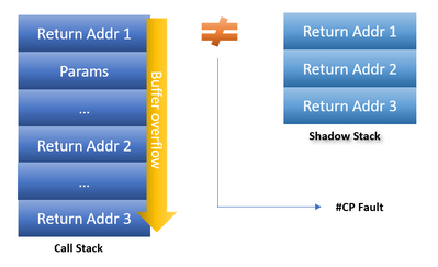

In this post, we will describe only the relevant parts of the Windows 10 implementation. This technology provides parity with program call stacks, by keeping a record of all the return addresses via a Shadow Stack. On every CALL instruction, return addresses are pushed onto both the call stack and shadow stack, and on RET instructions, a comparison is made to ensure integrity is not compromised.
If the addresses do not match, the processor issues a control protection (#CP) exception. This traps into the kernel and we terminate the process to guarantee security.
Shadow stacks store only return addresses, which helps minimize the additional memory overhead.
