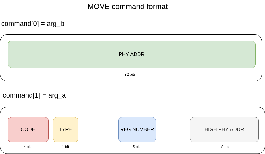

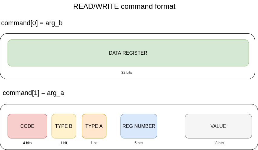

CMDQ_CODE_WRITE and CMDQ_CODE_READ
READ and WRITE commands format
The write command is used to write a value from a data register at the address from the address register. The read command reads the value at the address pointed by the address register and places the result into the data register.
Depending on the option bits (TYPE A and TYPE B in the figure), the address can be computed from a value called subsysID placed in the REG NUMBER field and an offset placed in the VALUE field. The subsysID will then be replaced by an actual physical address referenced in the kernel DTS.

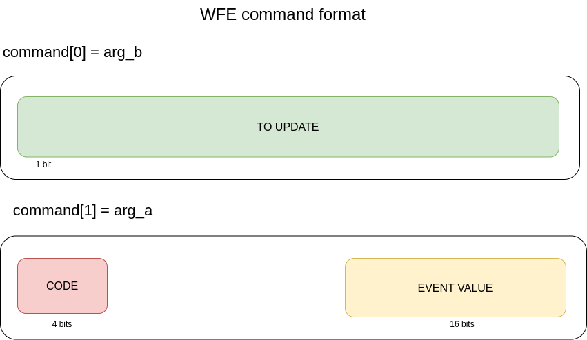

CMDQ_CODE_WFE
WFE command format
WFE stands for Wait For Event and clear. From what we understand, we can use it to block the usage of some registers (pretty much like we would use a mutex). The event flag to be used with this command is associated with a set of registers we are going to use in the command buffer. For example, for the registers CMDQ_DATA_REG_DEBUG (R7) and CMDQ_DATA_REG_DEBUG_DST (P11), the event (or token as it is called in the sources) CMDQ_SYNC_TOKEN_GPR_SET_4 has to be used. We need to use the WFE command at the beginning and at the end of each command buffer.
