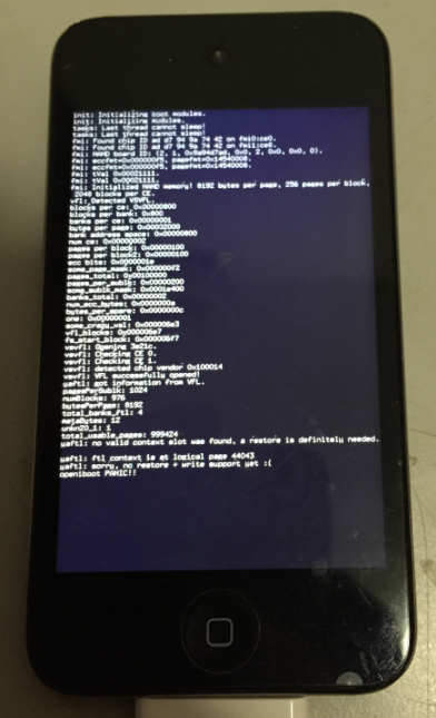

虽然openiboot PANIC了,但他不是也跑起来了…
检查代码是下面这个模块导致了PANIC:
MODULE_INIT(h2fmi_init)
关闭之。

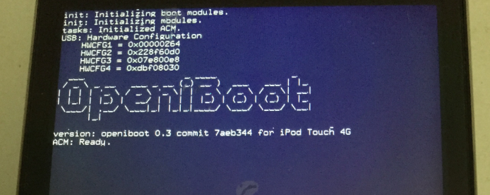

再次使用loadibec加载编译出来的ipt_4g_openiboot.bin出现下面界面。
Note:loadibec加载过程中,UART串口(参考内核调试的那个线缆)也是有调试信息输出的。

oibc
OiB client connected:
!<filename>[@<address>] to send a file, ~<filename>[@<address>]:<len> to receive a file
tasks: Initialized bootstrap.
tasks: Initialized irq.
tasks: Initialized uart reader.
clocks: Reconfigured clock 14 to 51300000. (0xa0000014)
clocks: Reconfigured clock 36 to 51300000. (0xb0000001)
clcd: Clock configured at 51300000.
pinot_init()
tasks: Last thread cannot sleep!
mipi_dsim_init()
clcd: p=2, m=57, s=1
pinot_init(): pinot_panel_id:      0xb2a40b88
pinot_init(): pinot_default_color: 0x00ffffff
pinot_init(): pinot_backlight_cal: 0x00000000
Found Gamma table 0x00a40b08 / 0x00ffff7f
init: Initializing boot modules.
init: Initializing modules.
tasks: Initialized ACM.
USB: Hardware Configuration
    HWCFG1 = 0x00000264
    HWCFG2 = 0x228f60d0
    HWCFG3 = 0x07e800e8
    HWCFG4 = 0xdbf08030
  ___                   _ ____              _
 / _ \ _ __   ___ _ __ (_) __ )  ___   ___ | |_
| | | | '_ \ / _ \ '_ \| |  _ \ / _ \ / _ \| __|
| |_| | |_) |  __/ | | | | |_) | (_) | (_) | |_
 \___/| .__/ \___|_| |_|_|____/ \___/ \___/ \__|
      |_|
version: openiboot 0.3 commit 7aeb344 for iPod Touch 4G
ACM: Ready.
aes
ACM: Starting aes
Usage: aes <enc/dec> <gid/uid/key> [data] [iv]
ACM: Done: aes. Error: Invalid parameter (0x80000001).
