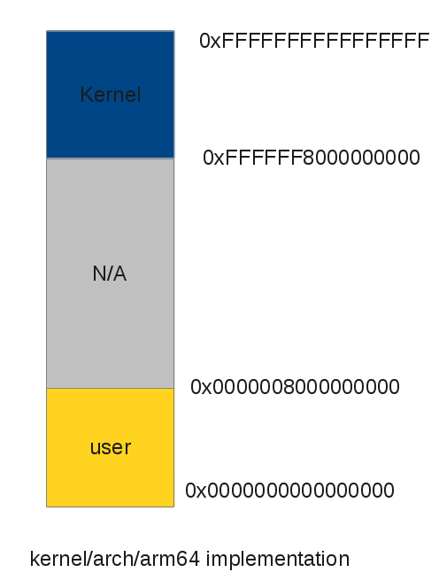

One good thing on ARM64 is that since we have enough virtual address bits, user space and kernel space can have their own 2^39 = 512GB virtual addresses!
All user virtual addresses have 25 leading zeros and kernel addresses have 25 leading ones. Address between user space and kernel space are not used and they are used to trap illegal accesses.

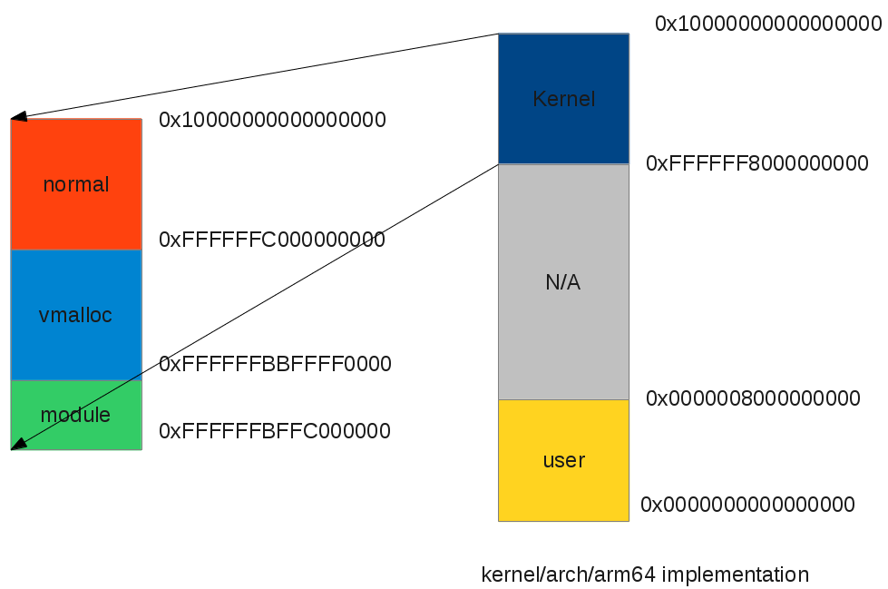

kernel space:
Although we have no ARM64 environment now, we can analysis the kernel virtual address space by reading the source code and observing a running AMD64 Linux box.
In arch/arm64/include/asm/memory.h, we can see the some differences: we have no lowmem zone, since the virtual address is so big that we can treat all memory of lowmem and do not have to worry about virtual address. (Yes, there is still a limit of kernel virtual address). Second, the order of different kernel virtual address changes:

You can see that there is no pkmap or fixmap, it's because the kernel is assuming every memory has a valid kernel virtual address and there's no need to create pkmap/fixmap.
ARM64 kernel virtual address space layout

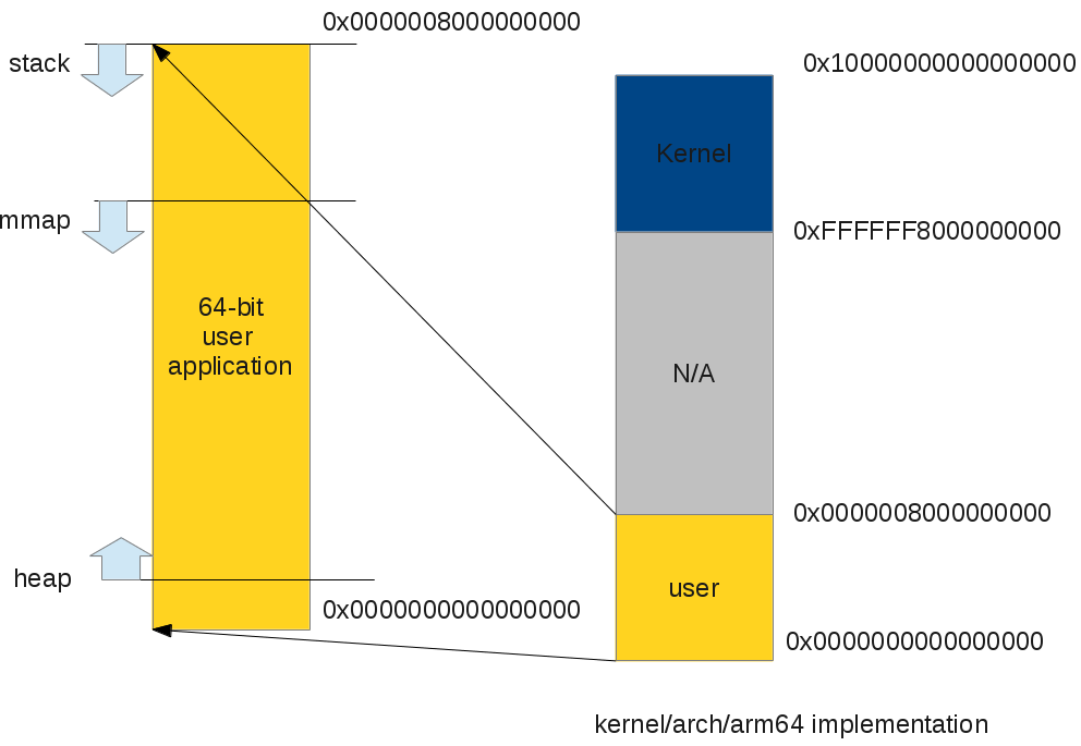

The memory layout implementation of user virtual address space looks like it does on ARM32. Since the available user space virtual address becomes 512GB, we can build a larger application on 64-bit CPUs.

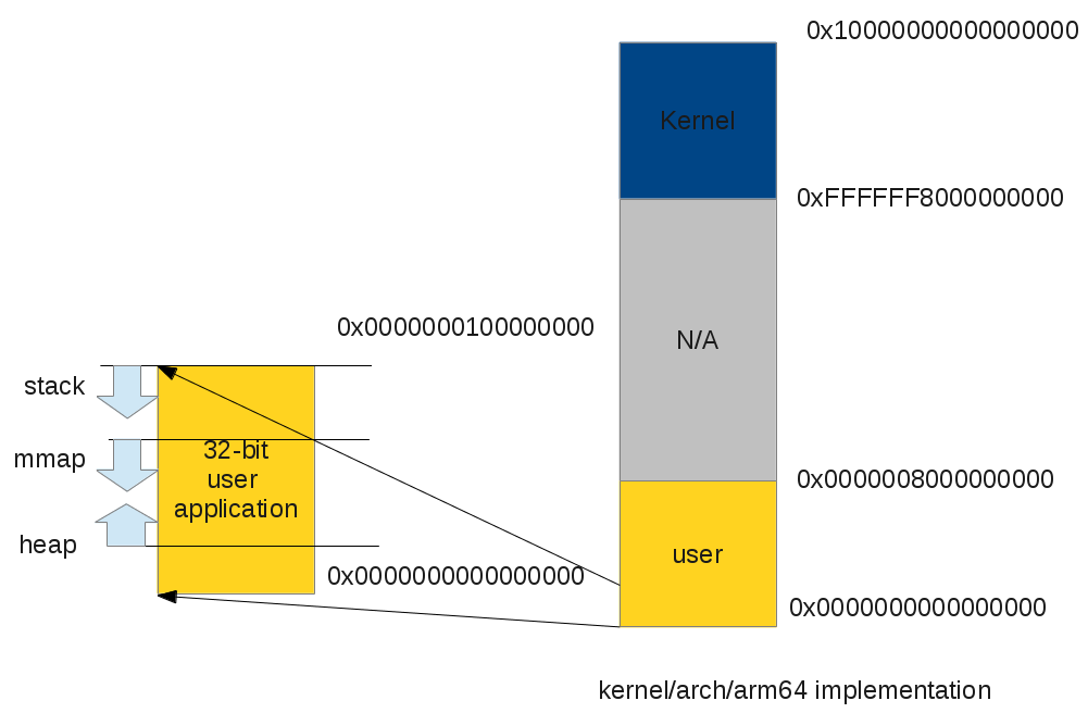

One interesting topic is that ARM claims the ARMv8 is compatible with ARM 32-bit applications, all 32-bit applications can run on ARMv8 without modification.How does the 32-bit application virtual memory layout look like on a 64-bit kernel?
Actually, all process on 64-bit kernel is a 64-bit process. To run ARM 32-bit applications, Linux kernel still create a process from a 64-bit init process, but limit the user address space to 4GB. In this way, we can have both 32-bit and 64-bit application on a 64-bit Linux kernel.

64-bit ARM applications on 64-bit Linux kernel
ARM64 64-bit user space program virtual address   space layout
32-bit ARM applications on 64-bit Linux kernel
ARM64 32-bit user space program virtual address   space layout
Note that the 32-bit application still have a 512GB kernel virtual address space and do not share it's own 4GB of virtual address space with kernel, the user applications have a complete 4GB of virtual address. On the other hand, 32-bit applications on 32-bit kernel have only 3GB of virtual address space.
