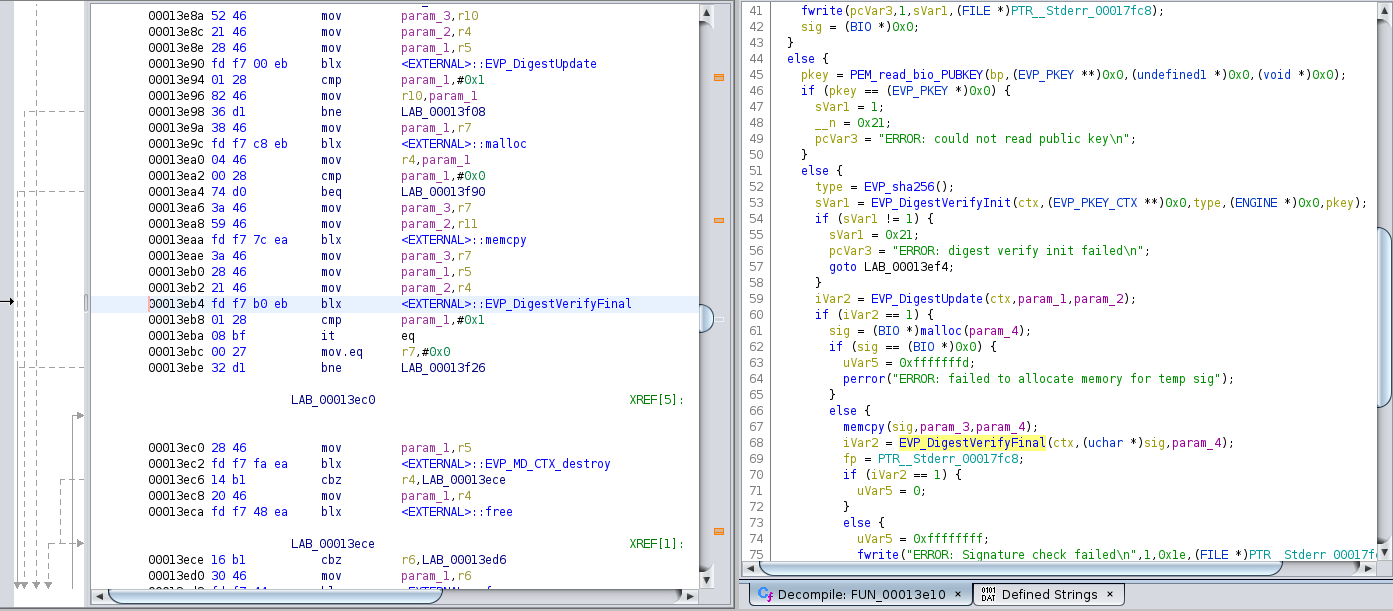

一个challenge的elf程序会自动生成mmx_challenge.txt,然后需要计算一个mmx_response.txt来登陆系统,现在希望能得到challenge如何校验内容和密文的,算法是sha256和rsa evp_md_ctx算法
可以自己生成一个秘钥对来进行测试,生成密文的算法有最好,我用java实现了一个,和mmx_response.txt里的密文对不上

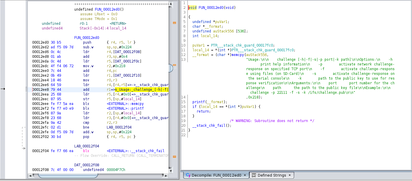

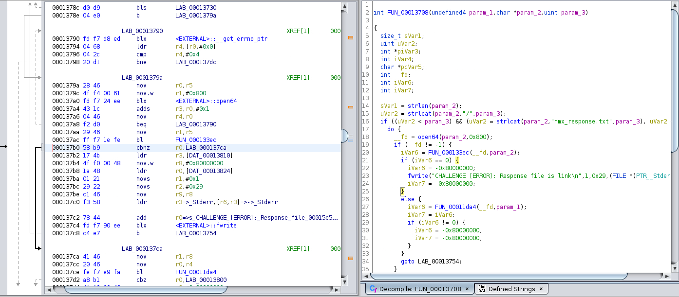

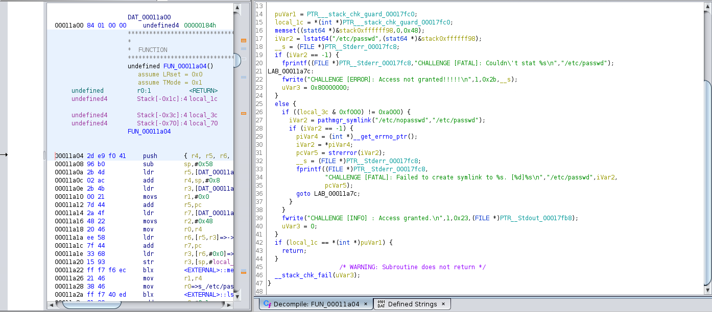

Hello
I have analyzed the binary "challenge" provided, but I can't run it because there are some missing files/devices such as Tegra Chip ID from /dev/nvsku/uid and FazitID from /mnt/ss; Therefore, mmx_challenge.txt is formed as follows (hexadecimal encoding):
2 (static)
743CC8BFFC6CBD43 (random challenge)
CLU28_MMX2P_PAG_NAR_G35_025PROD (static).
040583c00c0000007428340000000001 (Tegra Chip ID)
APU-00102.11.202AP11211 (FazitID)
The mmx_response.txt is:
[Hex Code Random Challenge] + [Signature
I haven't figured out how the signature should be generated, so if you can share the private key, the lost file, or the entire system image (such as the QNX disk image) with me, that's great so I can do an in-depth analysis
