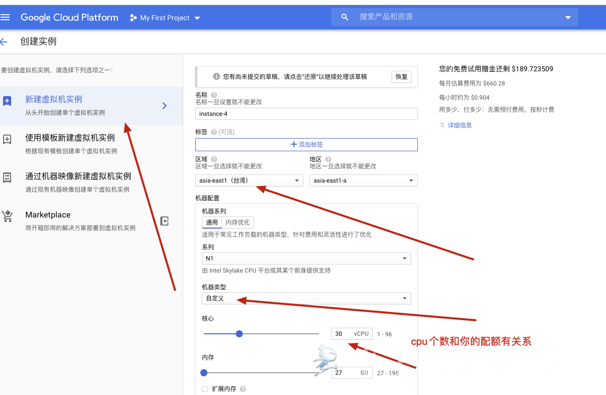

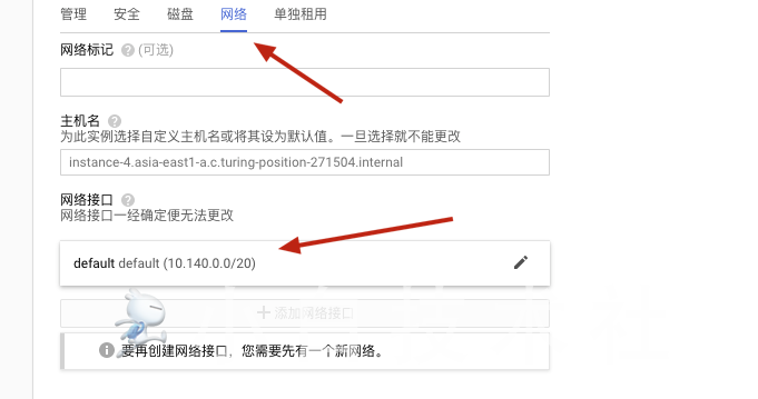

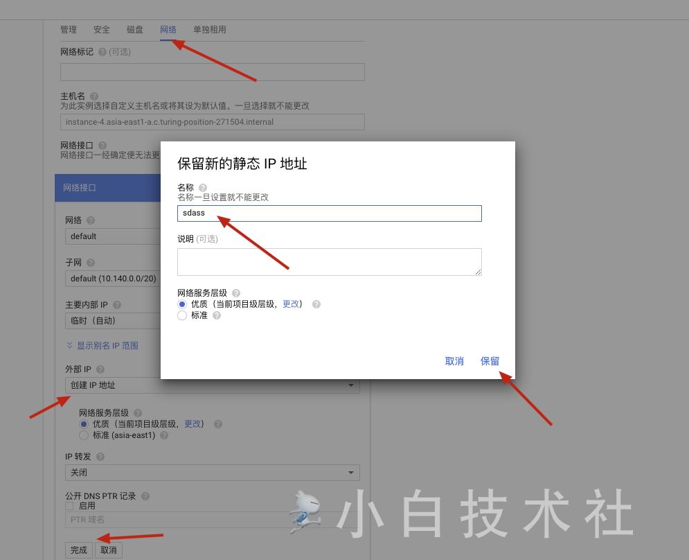

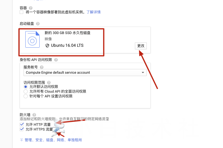

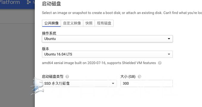

最后创建就好了。

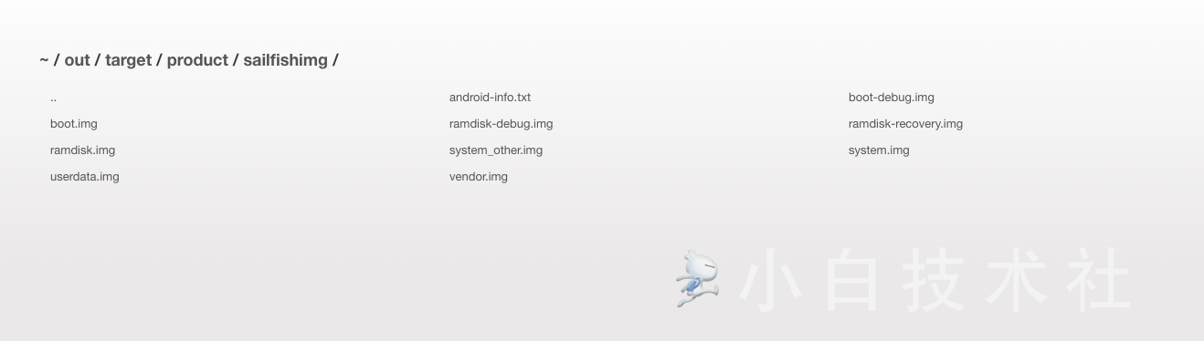

打包刷机镜像
tar zcvf sailfish.tar.gz sailfish
打包文件如下图所示
file
利用NodeJs的served来做文件服务器
file

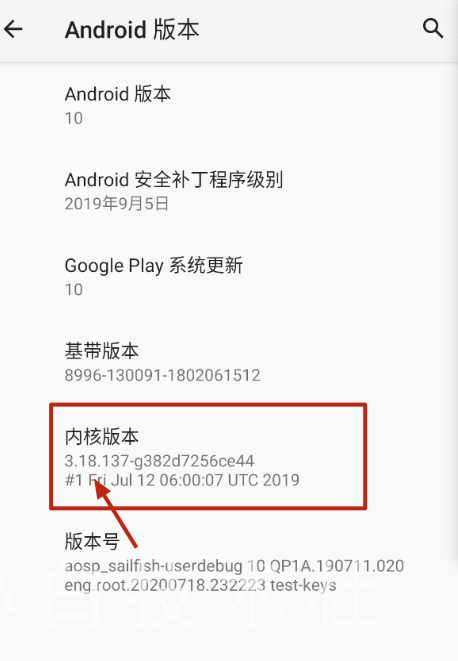

现在的内核版本是3.18,分支是g382d7256ce44

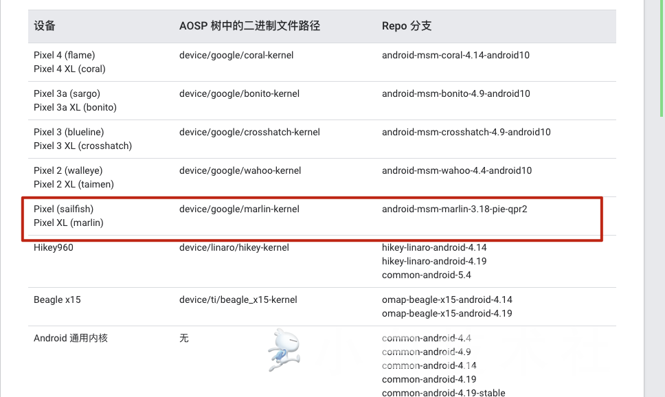

这里选择我们内核版本
file
我们去切到分支
409K9s2c8@1M7s2y4Q4x3@1q4Q4x3V1k6Q4x3V1k6S2L8X3c8J5L8$3W2V1i4K6u0W2k6$3!0G2k6$3I4W2M7$3!0#2M7X3y4W2i4K6u0W2j5$3!0E0i4K6u0r3K9$3g2J5L8X3g2D9i4K6u0r3L8i4y4E0i4K6u0r3i4K6u0n7i4K6u0r3M7X3g2X3M7#2)9J5c8X3S2W2j5h3c8K6i4K6u0r3j5h3&6V1M7X3!0A6k6q4)9J5k6r3#2K6L8g2)9J5k6r3#2S2M7X3I4A6L8W2)9J5k6o6y4Q4x3X3f1I4z5q4)9J5k6r3q4F1k6s2u0G2K9h3b7I4x3l9`.`.

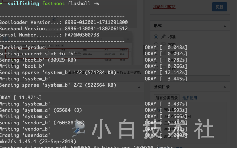

export ANDROID_PRODUCT_OUT=/Users/zxc/Downloads/sailfishimg
echo ${ANDROID_PRODUCT_OUT}
adb reboot bootloader
fastboot flashall -w

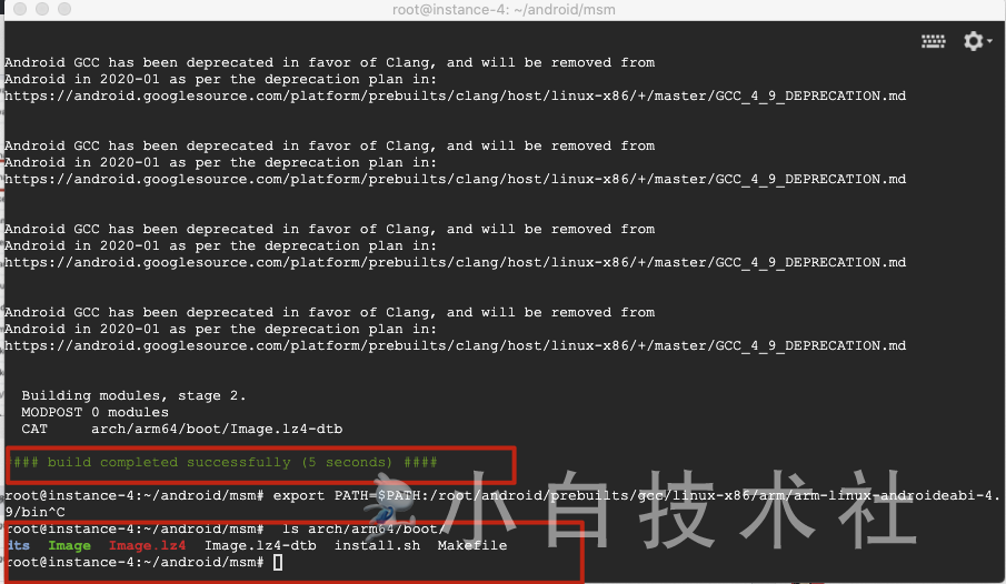

git clone c74K9s2c8@1M7s2y4Q4x3@1q4Q4x3V1k6Q4x3V1k6S2L8X3c8J5L8$3W2V1i4K6u0W2k6$3!0G2k6$3I4W2M7$3!0#2M7X3y4W2i4K6u0W2j5$3!0E0i4K6u0r3K9$3g2J5L8X3g2D9i4K6u0r3L8i4y4E0i4K6u0W2k6$3W2@1
cd msm
git checkout android-msm-marlin-3.18-pi-qpr1
sudo apt install bc #/bin/sh: 1: bc: not found
sudo apt-get install liblz4-tool #lz4c: not found
source build/envsetup.sh
lunch aosp_sailfish-userdebug
#上边命令需要在源码文件夹进行操作。
export PATH=$PATH:/root/android/prebuilts/gcc/linux-x86/arm/arm-linux-androideabi-4.9/bin #这里是在源码里面
export ARCH=arm64
export CROSS_COMPILE=aarch64-linux-android-
export SUBARCH=arm64
make marlin_defconfig
make -j60
ls arch/arm64/boot/
export TARGET_PREBUILT_KERNEL=/root/android/msm/arch/arm64/boot/Image.lz4-dtb
rm out/target/product/sailfish/boot.img &&  make -j60 bootimage
