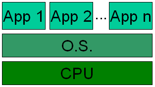

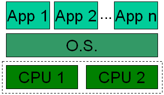

You may confuse virtualization with multitasking or even with HyperThreading. On multitasking, there is a single operating system and several programs running in parallel.  On virtualization, you can have several operating systems running in parallel, each one with several programs running. Each operating system runs on a “virtual CPU” or “virtual machine”. And HyperThreading simulates two CPUs were there is just one physical CPU for balancing performance using SMP (Symmetric Multi Processing), and these two CPUs cannot be used separately.
Figure 1: Multitasking.
Figure 2: HyperThreading.

Of course if a CPU has both HyperThreading and Virtualization Technology each virtual CPU will appear to the operating system as if two CPUs are available on the system for symmetric multiprocessing.

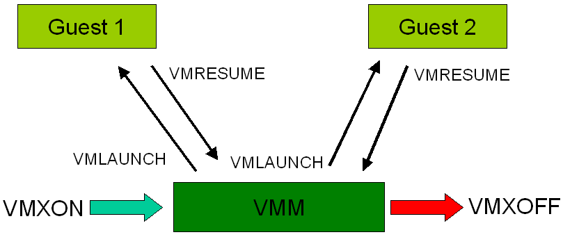

Processors with Virtualization Technology have an extra instruction set called Virtual Machine Extensions or VMX. VMX brings 10 new virtualization-specific instructions to the CPU: VMPTRLD, VMPTRST, VMCLEAR, VMREAD, VMWRITE, VMCALL, VMLAUCH, VMRESUME, VMXOFF and VMXON.
There are two modes to run under virtualization: root operation and non-root operation. Usually only the virtualization controlling software, called Virtual Machine Monitor (VMM), runs under root operation, while operating systems running on top of the virtual machines run under non-root operation. Software running on top of virtual machines is also called “guest software”.
To enter virtualization mode, the software should execute the VMXON instruction and then call the VMM software. Then VMM software can enter each virtual machine using the VMLAUNCH instruction, and exit it by using the VMRESUME. If VMM wants to shutdown and exit virtualization mode, it executes the VMXOFF instruction.
Figure 4: Virtualization technology operation.
Each guest shown on Figure 4 can be a different operating system, running its own software (even several programs at the same time as we have shown on Figure 3).
