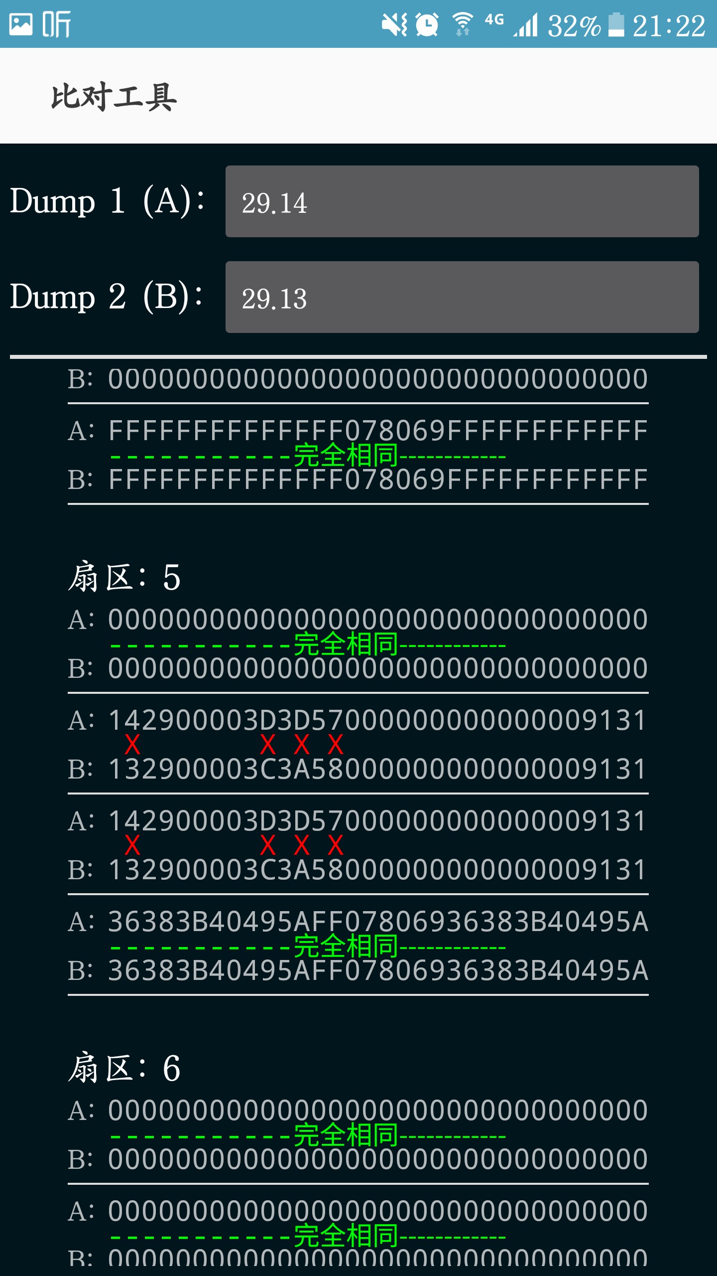

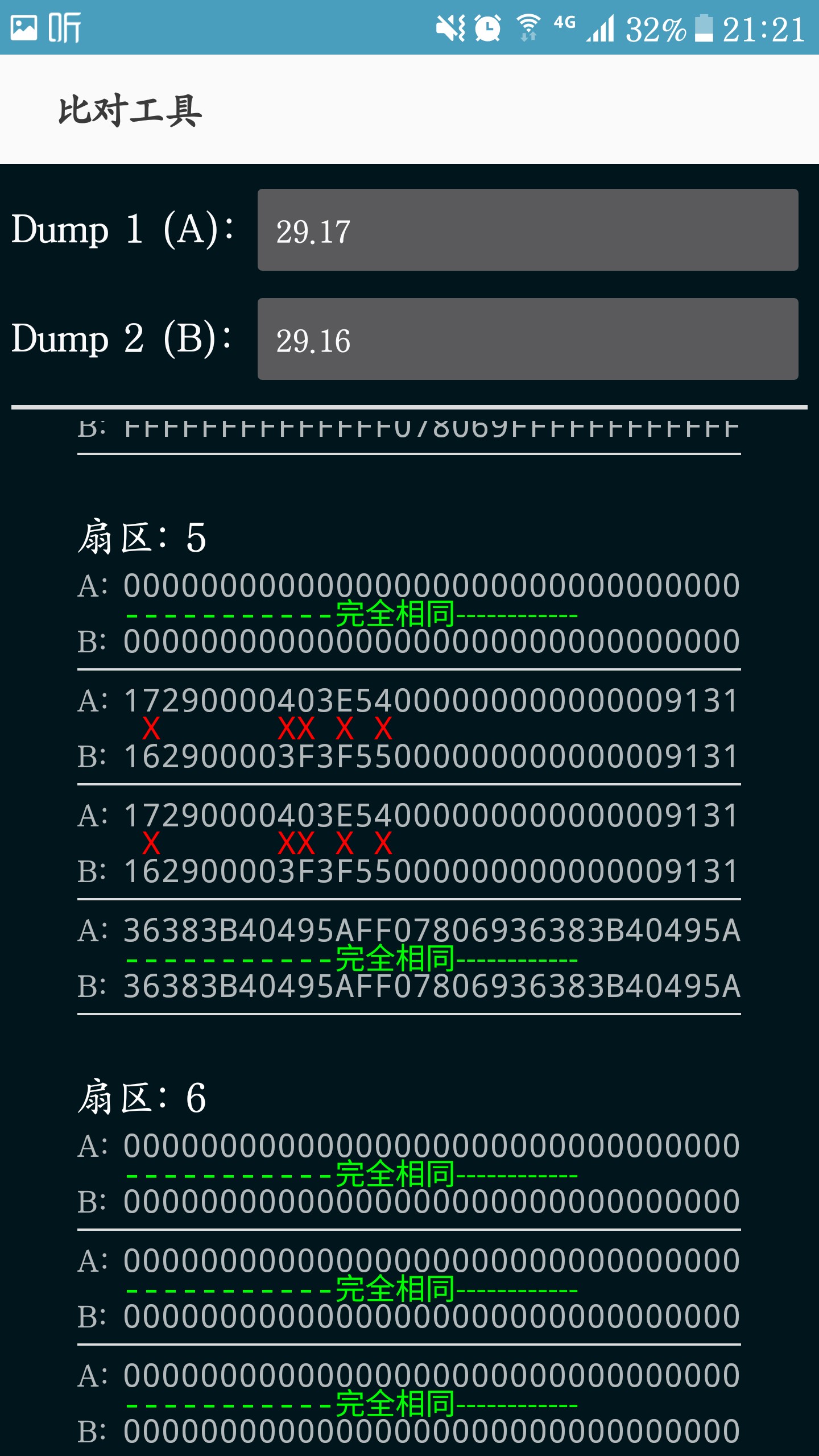

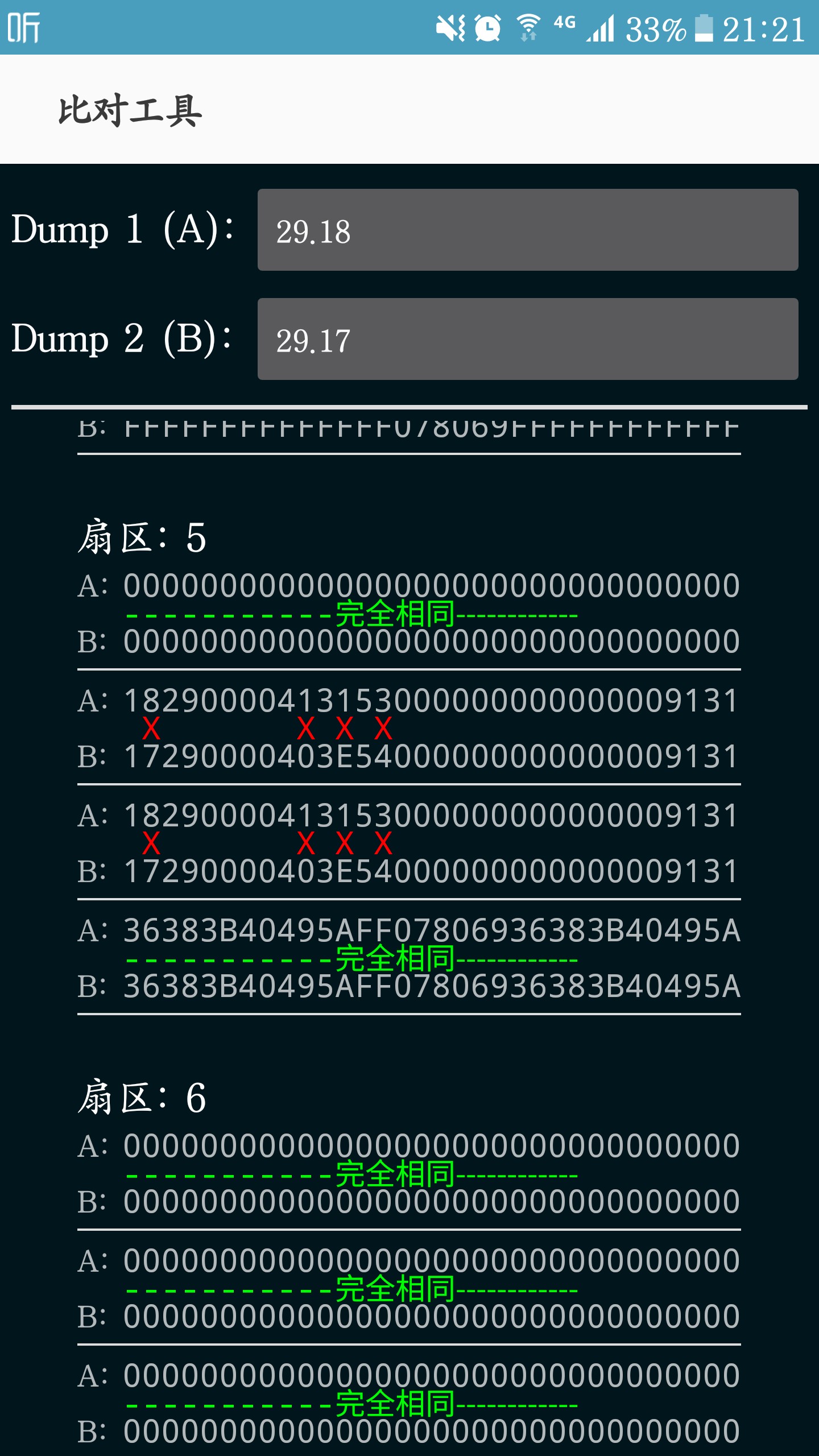

前4位可以看出是金额,只改前面数去刷卡就会变成5块,怎么推算出100块呢?
最新回复 (4)
雪    币: 23
28.99    99280000C1B166000000000000009131
29.00    00290000292965000000000000009131
04.99    990400009D9D52000000000000009131
29.19    19290000423052000000000000009131
29.18    18290000413153000000000000009131
29.17    17290000403E54000000000000009131
29.16    162900003F3F55000000000000009131
29.15    152900003E3C56000000000000009131
29.14    142900003D3D57000000000000009131
29.13    132900003C3A58000000000000009131
29.11    112900003A385A000000000000009131
29.10    1029000039395B000000000000009131
29.09    0929000032205C000000000000009131
29.08    0829000031215D000000000000009131
29.07    07290000302E5E000000000000009131
29.06  062900002F2F5F000000000000009131
